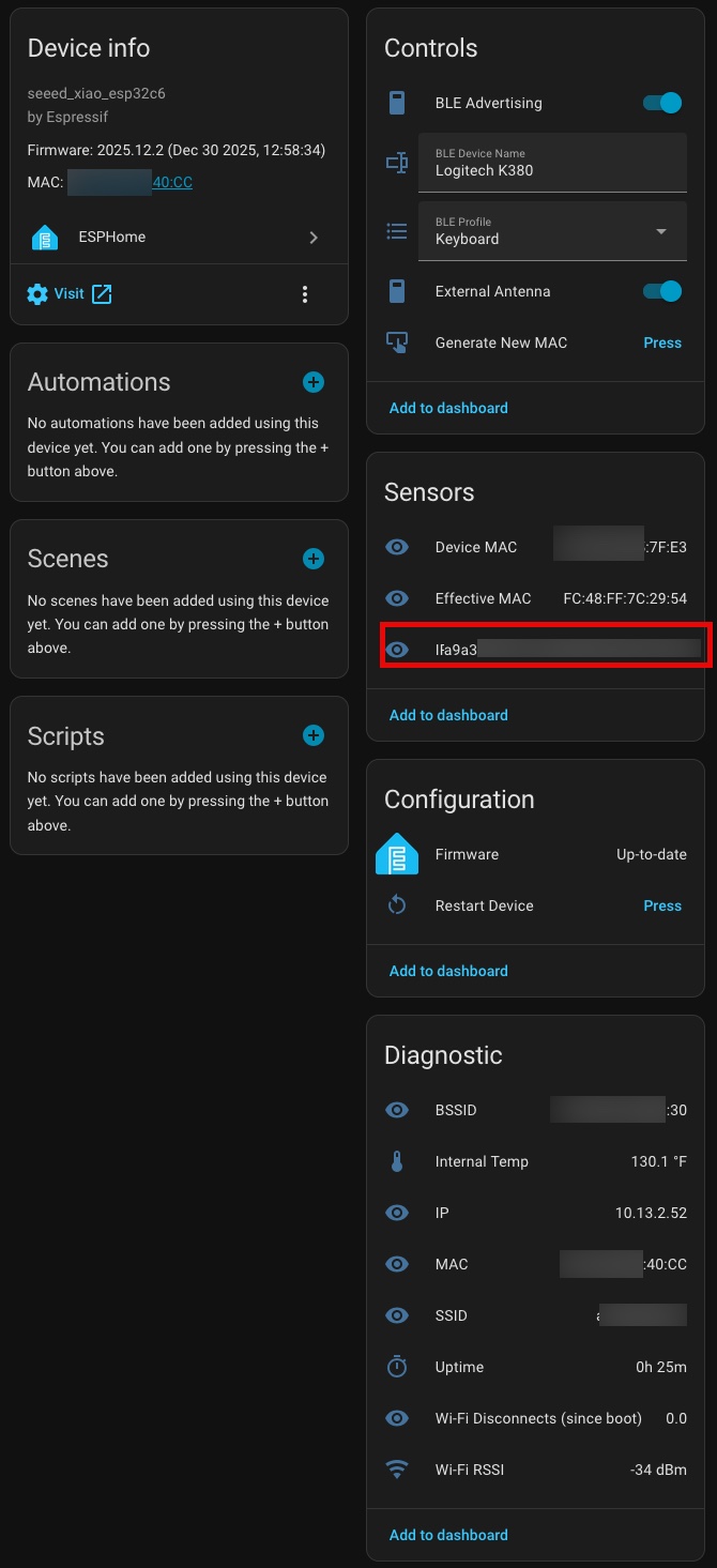

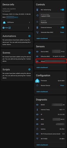

  1. Flash my ESPHome IRK Capture package to your favorite ESP32 device.
  2. Open the device in ESPHome and select heart rate or keyboard BLE emulation, depending on your device type.
  3. Pair your phone/watch to the broadcast BLE device.
  4. Copy the IRK from the ESPHome device page into the “Private BLE device” Home Assistant integration.
