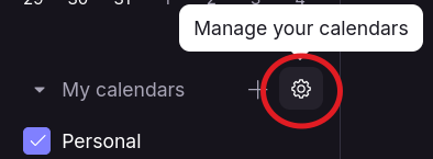

First: Proton Calendar Sharing Setup:
  1. Open the Proton Calendar Website and log in. (note that this functionality is NOT available in the mobile apps, so initial setup must be done from the mobile or desktop website)
  2. Open the Calendars Settings page on by clicking the gear icon:
  3. On the Calendar settings page, click the gear icon next to the calendar that you want to integrate into Home Assistant.
