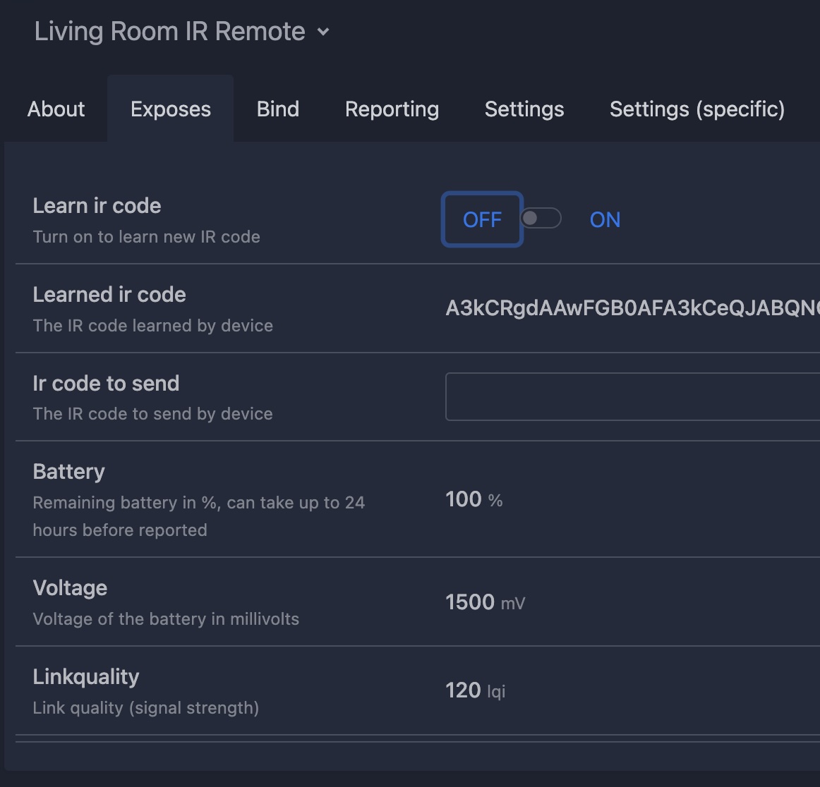

I’m using Zigbee2MQTT, so after pairing, it should look something like this:
Let’s make sure the controller works:
  • Click the ON button on the learn_ir_code entity.→ The LED on the device should light up.
  • Point your remote at the device and press the button you want to clone once .
  • The code will appear in the learned_ir_code field.
  • Copy that code into the ir_code_to_send field to test it (click away to trigger the send).
If everything works — great! You’re ready to create the entity you want to control using SmartIR.

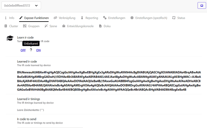

Hey, I also bought recently the IR Blaster, and I am not able to make it working. I am relativly new to the home assistant world, so i might have limited knowledge.
I connected the IR Blaster with mqtt. And here it is already different. The exposes does not state if it is on or off but rather say unknown:
I was able to fetch an IR signal, but when i am creating a script to fire it, it is not working.
I also Identified, after trying to fetch now multiple times my power button from my tv and received different IR Codes:
BY8NyQa0AUABAx0FtAHgIwHgHy/gGyfAI0AH4AMDwAFAE0ABQAfgAwNAAUAPAf//4HPHAt0BtKABQItAAUAH4AMDwAFAE0ABQAfgAwNAAUAPAf//4HPH4AEBQItAAUAH4AMDwAFAE0ABQAfgAwNAAUAPAf//4P3H4P3H4P3H4ADHAgW0AQ==
BYUNwgavAUABCBsFrwGvAdEBryABgAXgEwEB0QGAL+ANAQLRAa8gAYAF4AEnBFcCPQGvIAGAFwVXAvMArwGAC8AjAhsF0SAD4AEHwAFAEwGvAcAbAa8BwAMD0QGvAUALAf//4BPHQCUBVwKAe4ABA1cC8wBAFQOvAdEBQD8ErwHRAa/gBAGAD+ADBYAn4AMB4AMdgAvAI0AHgAMA0WAHwAEFGwWvAa8BgBNAC8ADA9EBrwFACwH//0DHQA0DrwEbBYAH4A0BgBvgAwUDGwWvAcAB4AMX4AMLQAEBGwXgAxGAC+AHAcAjQAcBGwVAB4ADBK8B0QGvIAFAD0ABQAeAAwDRYAdAAQUbBa8B//9AxwGvAUABQA/gAQEC0QGvIAHgAwXgBwEBGwXgAx2AC+ALAQMbBa8BgAHgDSNAFUAjwAdAC4ADQBGAAQMbBa8BQAECGwXRIANAB4ADQAFACwH//4DHA9EBrwFAD+ABAUARAa8B4AMF4AcBARsF4AMdgAvgDwEBGwXgBQPAAUAXA68B0QFAB+ADAwDRIAEFGwU9Af//QJ8C0QGvIAEBGwWAB+ATAeADIQMbBa8B4AUB4AMd4AELwCfgAREBrwHgAwtAAQEbBUARAdEBQAcCGwWv4AADBK8B0QGvIAFAE0ABQAeAAwDRYAcHrwGvARsFrwE=
BZENzAa0AUABAx4FtAHgGQEC5QG0oAHgHS8BtAHgGyfAI0AH4AMDwAFAE0ABQAfgAwNAAUAPAf//4CfH4AEBQD/gGwHgGyfAI0AH4AMDwAFAE0ABQAfgAwNAAUAPAf//4P3H4FfHwsVBc0ABQAfgAwNAAUAPAf//4f2P4QOPwTvgBwFBL+AXAcAjQAfgAwPAAUATQAFAB+ADA0ABQA8B///huo8CBbQB
BpwNugbpAbEgAQMoBbEB4CMB4B8v4BsnwCNAB+ADA8ABQBNAAUAH4AMDQAFADwH//0DHAbEBQAFAD+AjAeAfL+ADJ4ExgAHgAwvAI0AH4AMDwAFAE0ABQAfgAwMH6QGxASgFsQE=
BY8Nyga0AUABAx0FtAHgIwHgHy/gGyfAI0AH4AMDwAFAE0ABQAfgAwNAAUAPAf//4P3H4HnHAeMB4f2P4X+PAbQB4f2P4YKPAgW0AQ==
BVQN3Aa0AUABAx0FtAHgIwHgHy/gGyfAI0AH4AMDwAFAE0ABQAfgAwMHtAG0AR0FtAE=
BY0N0Qa0AUABAxwFtAHgIwHgHy/gGyfAI0AH4AMDwAFAE0ABQAfgAwNAAUAPAf//4P3H4P3H4P3H4P3H4IrHAgW0AQ==
BXwN1wayAUABAyEFsgHgIwFALwLhAbLgCgHgBRVAJ+AXAcAjQAfgAwPAAUATQAFAB+ADA0ABQA8B///gNcfgGwFAZ+AXAcAjQAfgAwPAAUATQAFAB+ADA0ABQA8B///gg8cB4QFAk+ADA8ABQBNAAUAH4AMDQAFADwH//+CDxwGyAUCT4AMDwAFAE0ABQAfgAwNAAUAPAf//4A3HAuEBsuAEAeADD8ALQD/gAwHAF0AB4AML4AMn4AMX4AMLwCNAB+ADA8AjQBNAAUAH4AMDB+EBsgEhBbIB
The list might not be complete and there could be more. I have a quite old panasonic tv.
Can you help me?
