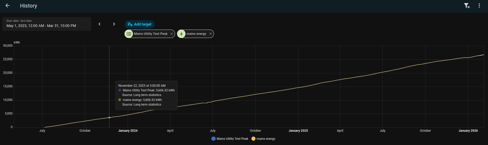

But I want sensor.mains_utility_test_peak to ‘inherit’ all historical values from sensor.shellyem_244cab417eaf_channel_1_energy up till now
So when I replace the old mains entity with 2 new once in the energy dashboard - all my historical data will be intact.

Also, do all manipulation that I will be talking here, while HA is off, so we don’t conflict with a running system.
Here is my SQL migration file, that will do:
  • Delete all data in ‘new’ entity
  • Copy long term statistics from OLD into NEW
  • Copy short term statistics from OLD into NEW
  • Copy ‘states’ history from OLD into NEW
Copy these SQL statements into a file on your PC, and do a bit of find-replace.
  • Find: sensor.shellyem_244cab417eaf_channel_1_energy | Replace this ID with ID of your old entity (where we will be copying data from)
  • Find: sensor.mains_utility_test_peak | Replace this ID with ID of your new entity (where we will be copying data into, and deleting old data)

Run migration
You can run the migration with command like this (Linux):
sqlite3 /PATH/TO/YOUR/HA/DB/home-assistant_v2.db < /PATH/TO/MIGRATION/FILE/migration.sql
Alternatively, while developing this script, I was using DataGrip, which can execute this from it’s console, select all and press Ctrl+Enter.
Migrating cost
If you are migrating/copying cost values too, you have these additional steps to follow.
Copy the migration file, and do search replace like above, BUT adding _cost at the end of entities.
For example: sensor.shellyem_244cab417eaf_channel_1_energy will become sensor.shellyem_244cab417eaf_channel_1_energy_cost
And likewise, sensor.mains_utility_test_peak will become sensor.mains_utility_test_peak_cost
State file shenanigans
After running SQL migration script, the very last line of the output will print the last value of your old sensor (from which we have copied the data)
We will need this value in this step. For example, my value was 26709.2073

Result
Here is a quick result after doing the migration - as you can see the data matches up between old and new entity.
Hope this helps someone!
