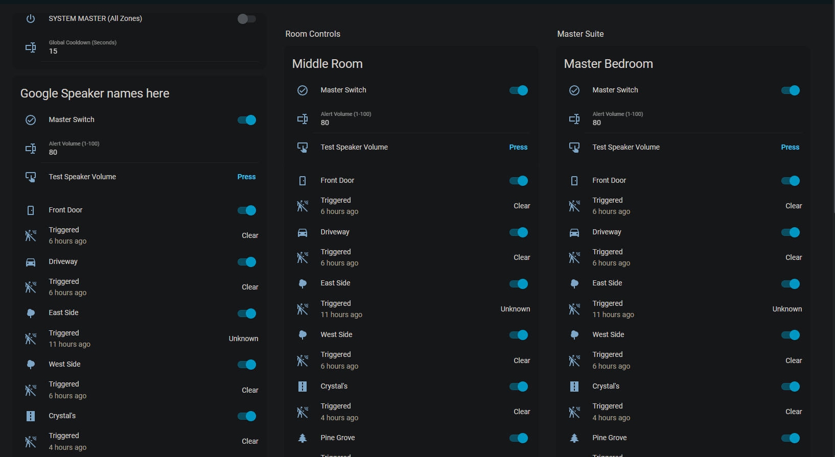

First thing is first, I made a guide on a given driveway sensor that is solar and works a half mile or so away. Guide - How to hook up eMacros driveway sensors to Home Assistant
But for the rest of this, it should work with whatever system you have.
The image above is a simple dashboard. Basically it list all the google speakers (and this means it likely will work with amazon and others too). And it allows a custom setting for each. This includes which sensors trigger in which room, volume per (I have it where at least with google speakers it will save the current sound, make it whatever listed here and then back to what it was after the message it played. And there is a global cool down. This prevents alarms from spamming you which was a MAJOR issue with the native emacros system.
I didn’t add in the code I will share on notifying you outside (sms, push, etc) but keep that in mind. Plus you can expand it to outside lights where they trigger things like that. But I wouldn’t recommend adding that to the dashboard since it will clutter it.
Note:
  1. You will see unknown with the time under the sensor if they haven’t trigger that day. You can still click on the sensor on the dashboard to see when it actually triggered. But if it triggered that day then it should show it.
  2. If you do this, you will need a mertic ton of helpers. I highly recommend having AI (gemini, chatgpt, etc) just make you the helpers and you can paste into the config file so it will save you time. Otherwise you will have to manually create each one.
There is in this code for
  1. The dashboard
  2. Driveway announcer (the core of it how it announces)
  3. Switch sync (this makes sure everything syncs)
  4. button so like if you have a speaker in your office and have a meeting you can get it to not do it. It saves, turns off for that room, then when you release it it restores. I think I also have a reset in it at midnight on the off chance the person forgets to reset it.
Note all the code is anonymize.

            'binary_sensor.front_door': 'front_door',
            'binary_sensor.front_porch_camera_motion': 'front_door',
            'binary_sensor.driveway_alarm': 'driveway',
            'binary_sensor.east_side_yard': 'east_side',
            'binary_sensor.side_yard_next_to_driveway': 'west_side',
            'binary_sensor.neighbor_driveway': 'zone_c',
            'binary_sensor.back_lot': 'zone_d'
          {{ mp3_map[sensor_to_id[trigger.entity_id]] }}
        {% endif %}
      trigger_id_map:
        binary_sensor.front_door: front_door
        binary_sensor.front_porch_camera_motion: front_door
        binary_sensor.driveway_alarm: driveway
        binary_sensor.east_side_yard: east_side
        binary_sensor.side_yard_next_to_driveway: west_side
        binary_sensor.neighbor_driveway: zone_c
        binary_sensor.back_lot: zone_d
      t_id: "{{ trigger_id_map[trigger.entity_id] if not is_test else '' }}"
  - if:
      - condition: template
        value_template: >-
          {{ not is_test and is_state('timer.driveway_global_cooldown',
          'active') }}
    then:
      - stop: System is on global cooldown.
  - if:
        value_template: "{{ not is_test }}"
    then:
      - action: timer.start
          entity_id: timer.driveway_global_cooldown
          duration: "{{ states('input_text.driveway_global_cooldown') | int(30) }}"
  - parallel:
      - action: input_number.set_value
          entity_id: input_number.office_volume
          value: >-
            {{ state_attr('media_player.office_speaker', 'volume_level') |
            float(0.5) }}
          entity_id: input_number.living_room_volume
          value: >-
            {{ state_attr('media_player.living_room_speaker', 'volume_level') |
            float(0.5) }}
          entity_id: input_number.kitchen_display_volume
          value: >-
            {{ state_attr('media_player.kitchen_display', 'volume_level') |
            float(0.5) }}
          entity_id: input_number.primary_bedroom_volume
          value: >-
            {{ state_attr('media_player.primary_bedroom_speaker', 'volume_level')
            | float(0.5) }}
          entity_id: input_number.bedroom_1_volume
          value: >-
            {{ state_attr('media_player.bedroom_1_speaker', 'volume_level') |
            float(0.5) }}
          entity_id: input_number.bedroom_2_volume
          value: >-
            {{ state_attr('media_player.bedroom_2_speaker', 'volume_level') |
            float(0.5) }}
  - parallel:
      - if:
            value_template: |
              {{ (trigger.entity_id == 'input_button.test_office_alarm') or
                 (not is_test and is_state('input_boolean.notify_office', 'on') and is_state('input_boolean.notify_office_' ~ t_id, 'on')) }}
        then:
          - action: media_player.volume_set
              entity_id: media_player.office_speaker
              volume_level: >
                {% set val = states('input_text.office_alert_volume') |
                float(80) %} {{ ([0, val, 100] | sort)[1] / 100 }}
          - action: media_player.play_media
              announce: true
              media:
                media_content_id: "{{ mp3_file }}"
                media_content_type: audio/mpeg
                metadata: {}
      - if:
            value_template: |
              {{ (trigger.entity_id == 'input_button.test_kitchen_alarm') or
                 (not is_test and is_state('input_boolean.notify_kitchen', 'on') and is_state('input_boolean.notify_kitchen_' ~ t_id, 'on')) }}
        then:
              entity_id: media_player.kitchen_display
              volume_level: >
                {% set val = states('input_text.kitchen_alert_volume') |
              announce: true
              media:
                metadata: {}
      - if:
            value_template: |
              {{ (trigger.entity_id == 'input_button.test_bedroom_1_alert') or
                 (not is_test and is_state('input_boolean.notify_bedroom_1', 'on') and is_state('input_boolean.notify_bedroom_1_' ~ t_id, 'on')) }}
        then:
              entity_id: media_player.bedroom_1_speaker
              volume_level: >
                {% set val = states('input_text.bedroom_1_alert_volume') |
              announce: true
              media:
                metadata: {}
      - if:
            value_template: >
              {{ (trigger.entity_id == 'input_button.test_living_room_alert')
              or
                 (not is_test and is_state('input_boolean.notify_living_room', 'on') and is_state('input_boolean.notify_living_room_' ~ t_id, 'on')) }}
        then:
              entity_id: media_player.living_room_speaker
              volume_level: >
                {% set val = states('input_text.living_room_alert_volume') |
              announce: true
              media:
                metadata: {}
      - if:
            value_template: >
              {{ (trigger.entity_id == 'input_button.test_primary_bedroom_alarm')
              or
                 (not is_test and is_state('input_boolean.notify_primary_bedroom', 'on') and is_state('input_boolean.notify_primary_bedroom_' ~ t_id, 'on')) }}
        then:
              entity_id: media_player.primary_bedroom_speaker
              volume_level: >
                {% set val = states('input_text.primary_bedroom_alert_volume') |
              announce: true
              media:
                metadata: {}
      - if:
            value_template: |
              {{ (trigger.entity_id == 'input_button.test_bedroom_2_alarm') or
                 (not is_test and is_state('input_boolean.notify_bedroom_2', 'on') and is_state('input_boolean.notify_bedroom_2_' ~ t_id, 'on')) }}
        then:
              entity_id: media_player.bedroom_2_speaker
              volume_level: >
                {% set val = states('input_text.bedroom_2_alert_volume') | float(80)
              announce: true
              media:
                metadata: {}
  - delay: "00:00:10"
  - parallel:
          volume_level: "{{ states('input_number.office_volume') | float(0.5) }}"
          volume_level: "{{ states('input_number.living_room_volume') | float(0.5) }}"
          volume_level: "{{ states('input_number.kitchen_display_volume') | float(0.5) }}"
          volume_level: "{{ states('input_number.primary_bedroom_volume') | float(0.5) }}"
          volume_level: "{{ states('input_number.bedroom_1_volume') | float(0.5) }}"
          volume_level: "{{ states('input_number.bedroom_2_volume') | float(0.5) }}"
mode: queued
max: 10
Smart switch
alias: Driveway Smart Switch Sync
description: Cascades master switches to sub-switches and updates master status.
triggers:
  - trigger: state
    entity_id: input_boolean.driveway_system_master
  - trigger: state
    entity_id:
      - input_boolean.notify_office
      - input_boolean.notify_living_room
      - input_boolean.notify_kitchen
      - input_boolean.notify_primary_bedroom
      - input_boolean.notify_bedroom_1
      - input_boolean.notify_bedroom_2
actions:
  - choose:
      - conditions:
          - condition: trigger
        sequence:
          - action: >-
              input_boolean.turn_{{
              states('input_boolean.driveway_system_master') }}
              entity_id:
      - conditions:
        sequence:
          - variables:
              new_state: "{{ states(trigger.entity_id) }}"
          - action: input_boolean.turn_{{ new_state }}
              entity_id: >
                {{ trigger.entity_id }}_front_door, {{ trigger.entity_id
                }}_driveway, {{ trigger.entity_id }}_east_side, {{
                trigger.entity_id }}_west_side, {{ trigger.entity_id }}_zone_c,
                {{ trigger.entity_id }}_zone_d
mode: parallel
Smart button
alias: Office Smart Button (Memory)
description: >-
  Saves/Restores sub-switch states and verbally notifies office speaker at
  current volume. Includes manual override.
triggers:
  - trigger: state
    entity_id: input_boolean.office_button
    to: "off"
  - trigger: state
    to: "on"
  - trigger: device
    domain: zha
    device_id: your_zigbee_button_device_id
    type: remote_button_long_press
    subtype: remote_button_long_press
  - trigger: state
    entity_id:
      - input_boolean.notify_office_front_door
      - input_boolean.notify_office_driveway
      - input_boolean.notify_office_east_side
      - input_boolean.notify_office_west_side
      - input_boolean.notify_office_zone_c
      - input_boolean.notify_office_zone_d
    to: "on"
  - trigger: time
    at: "00:00:00"
actions:
  - choose:
      - conditions:
        sequence:
          - action: input_boolean.toggle
      - conditions:
        sequence:
          - if:
                value_template: >
                  {{ expand('input_boolean.notify_office_front_door',
                  'input_boolean.notify_office_driveway',
                  'input_boolean.notify_office_east_side',
                  'input_boolean.notify_office_west_side',
                  'input_boolean.notify_office_zone_c',
                  'input_boolean.notify_office_zone_d')
                      | selectattr('state', 'eq', 'on') | list | count == 0 }}
            then:
              - action: scene.turn_on
                  entity_id: scene.office_saved_state
          - choose:
              - conditions:
                  - condition: not
                    conditions:
                      - condition: time
                        after: "06:00:00"
                        before: "21:00:00"
                sequence:
                  - action: tts.speak
                      cache: true
                      media_player_entity_id: media_player.office_speaker
                      message: Office alerts on
                      device_id: your_media_player_device_id
      - conditions:
          - condition: not
            conditions:
              - condition: time
                after: "06:00:00"
                before: "21:00:00"
        sequence:
          - action: tts.speak
              cache: true
      - conditions:
        sequence:
          - choose:
              - conditions:
                  - condition: not
                    conditions:
                      - condition: time
                        after: "06:00:00"
                        before: "21:00:00"
                sequence:
                  - action: tts.speak
                      cache: true
                      message: Office alerts off
          - action: scene.create
              scene_id: office_saved_state
              snapshot_entities:
          - action: input_boolean.turn_off
              entity_id:
      - conditions:
          - condition: state
            state: "off"
        sequence:
          - action: input_boolean.turn_on
      - conditions:
            id:
              - Time
        sequence:
mode: restart
