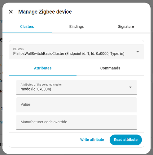

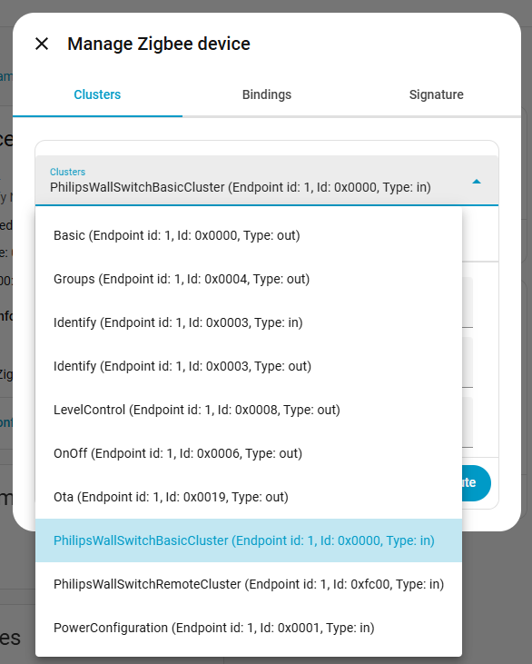

I have found this Guide to hue wall switch push button, But i can’t seem to get this working. could someone please help me out with a more detailed guide?
i have found this forum post as well: https://community.home-assistant.io/t/how-to-configure-the-philips-hue-wall-module-to-use-push-button-momentary-type-wall-switches-zha/451125/27
I have a Zigbee button that suports short double and long press. I made an automation that has triggers for each of the three and then conditional actions based on which trigger happens. I don’t have anything on the long press currently. I’m not sure if something like this would work for you or not.

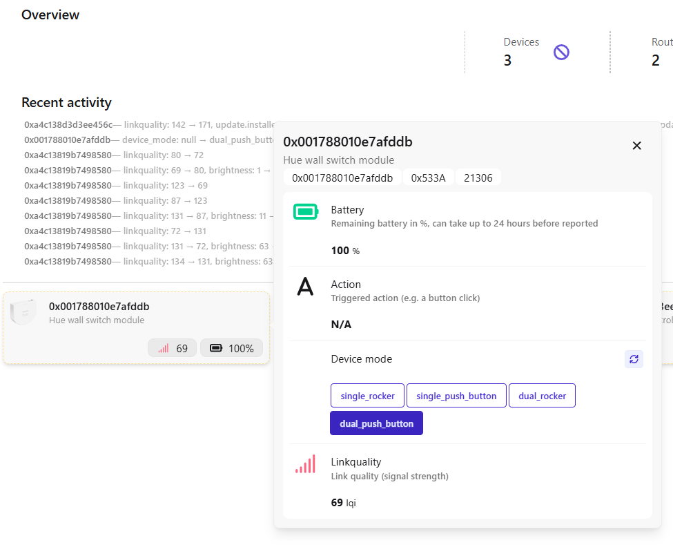

I have ditched ZHA and set up Zigbee2MQTT. I have added the philips hue wall switch and could set the device mode to dual push button.
Now i want to see what is triggered in this device.
it seems to have:
left_press
left_press_release
For holding we have:
left_press
‘left_hold’
‘left_hold_release’
Double tapping does not register
triple tapping does not register.
Can someone please tell me if the task i have thought of is achievable with this device.

As you already figured out by yourself, the Hue Wall Swich Module does not support double/triple click. This is a device limitation, not Z2M’s.
