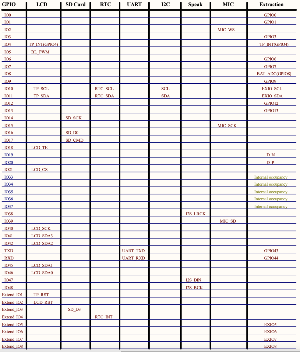

You can use the CUSTOM model, but will need to provide the full config, or a new model can be added with a PR.
what i mean is the Guition 1.8" v1 works as it is, no change needed besides setting the reset pin, i added the ioextender and added the correct pin and it works perfectly without having to fake a pin so i think there’s no need for a new driver? :person_shrugging:

pca9554:
  - id: pca9554a_device
    address: 0x20
spi:
  type: quad
  clk_pin: 40
  data_pins: [46, 45, 42, 41]
display:
  - platform: mipi_spi
    model: JC3636W518
    rotation: 180
    cs_pin: 21
    reset_pin:
      pca9554: pca9554a_device
      number: 1
    update_interval: never
    pages:
at least i think i got the pin right? 2 is 1, right?

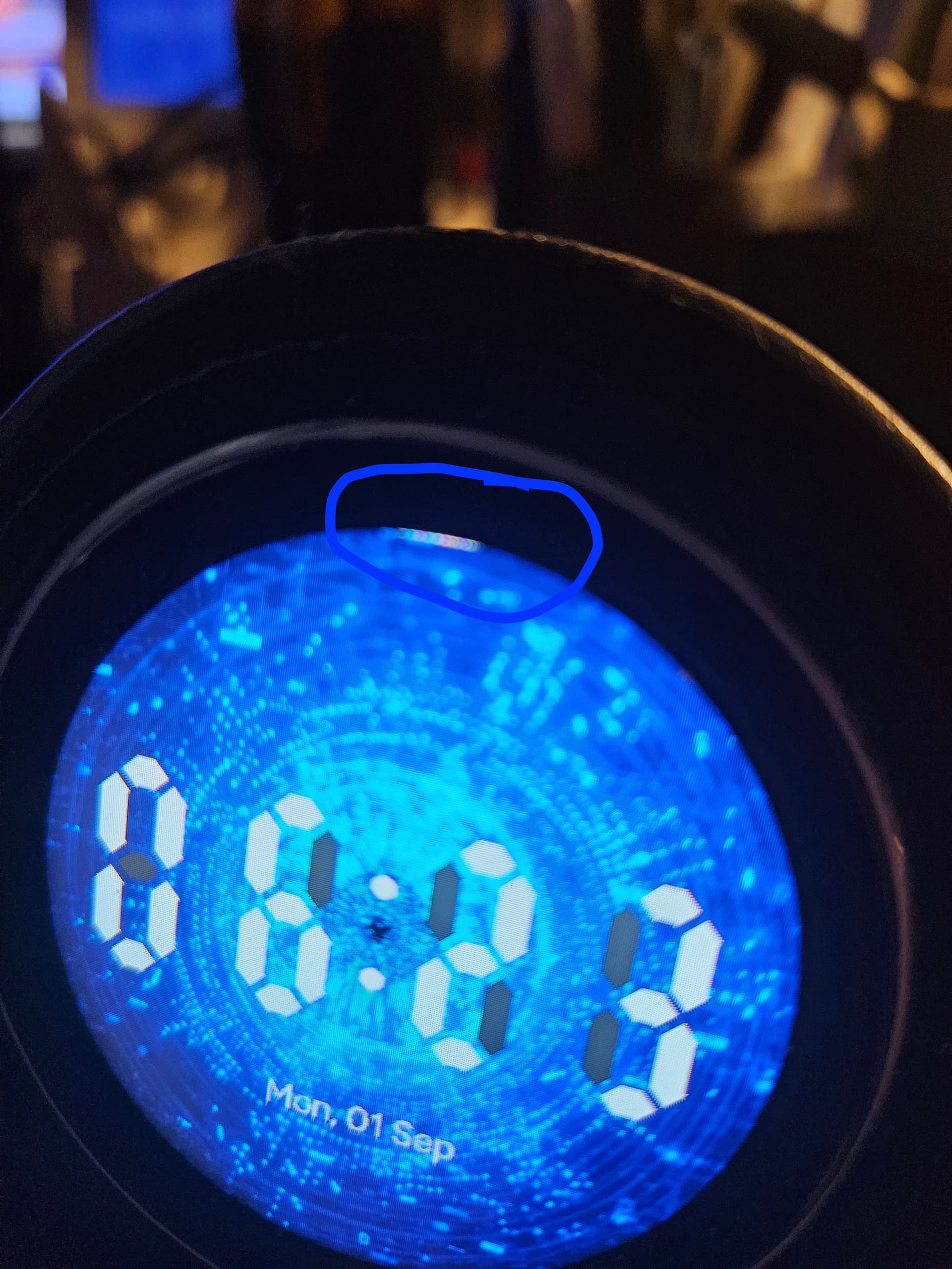

i had someone report that with the guition displays the image is 1 pixel down, i use the same yaml for several displays and checked, it only happens when using guition display driver, both the normal for v1 and the one from the pr for v2. i have not testet with standard yaml but can if you don’t see it?
i’m thinking it could be the driver since all other displays don’t do that with same yaml?, let me know if you want me to test with some standard yaml.

and it still happens, but only when using rotate. (and only after power been unplugged/replugged), if i put rotate to 0 it’s fine, put it back to 180, it’s fine, unplug power,/replug, it’s back. :man_shrugging: (still only when using rotate)
hope this helps.
problem seems to be solved by setting the size manually in display, strangely enough :man_shrugging:

The predefined config for the JC3636W518 has an offset of 1 since the board I used for testing seemed to require that. Providing the dimensions in the yaml overrides that and sets the offset to a default of 0.
I’m not currently able to test this.
Yes that solves the problem :+1:
