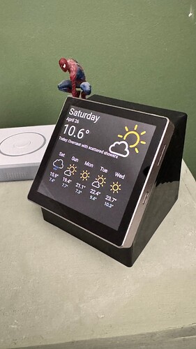

I made a clock panel with a few extras. when its dark the display brightness drops to 27% and the front page labels go green. At 11:30pm the backlight is switched off and come back on at 5:00am brightens back to 50%. Touch when backlight is off will turn on and the front page appears. It will turn off the backlight after 15 secs.
Black box
CPC UK Black Box
White Box
CPC UK White box
That little desktop box is great. I wonder if they are available outside the UK?
