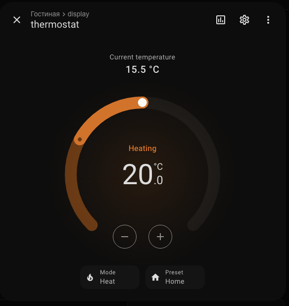

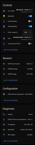

The thermostat itself does not need to be changed at all, it is a built-in entity (created by the device) climate that controls the relay device, but you must enter your temperature sensor from home assistant so that it understands when to turn on and when to turn off the relay. And in home assistant you should see this! These are all entities created by the device

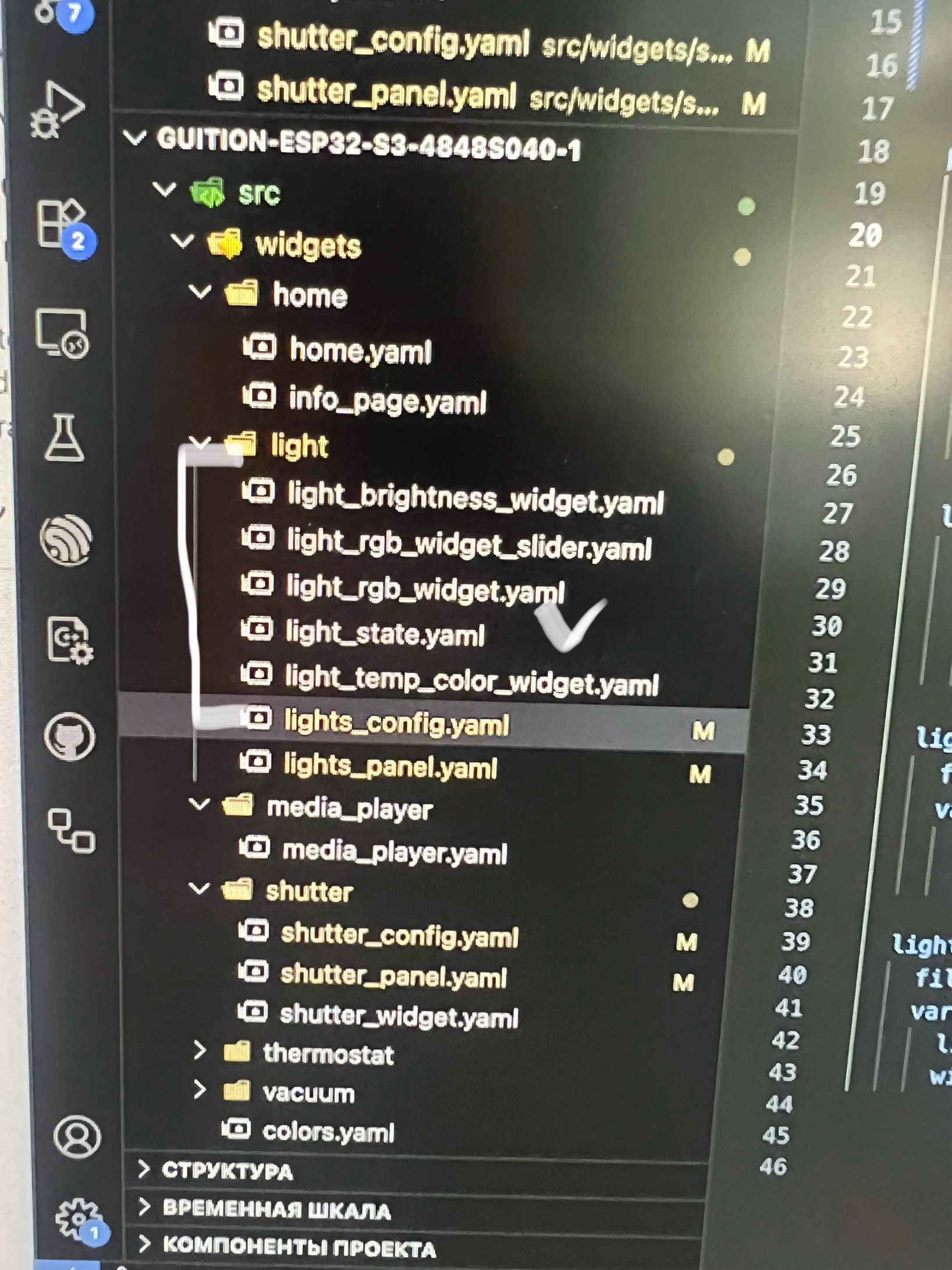

Better via vscode, but you can also download it to the esphome folder, the main thing is that the structure is such that the main.yaml file is in the root of the esphome folder, then edit it for your entities and compile! Don’t forget to install the custom component in the home assistant and run it (make sure that new services are visible in HA). Well, enter your data in secrets.yaml
Sorry I was looking at other example yaml that points to this ‘button.ac_temp_increase_master_bedroom’ that I couldn’t find. I assumed I needed to use helper and create a button but that just adds ‘input_button.’ line instead
Also, i don’t quite understand what’s the cooling and heating relay are for
Thanks, not too familiar using esphome with vscode. So I’ll just stick to using the esphome addon
In another example, buttons are made apparently to control the increase and decrease of temperature. I have made a full-fledged climate component. For example, a thermostat. You connect, for example, a thermostatic head of a warm floor to the screen (one of the relays), then simply set the desired comfortable temperature for you, and if the set temperature is higher than the current one in the room, the relay will automatically turn on (the thermostatic head will open) and the water in the warm field will heat up or the electric warm floor will turn on and as soon as the current temperature equals the set one, the relay will automatically turn off the thermostatic head/electric floor. But if you want to control another thermostat that you have in HA through the screen, this can also be done, but you will have to change the logic in the widget.
My button is a node red function which then calls a service to decrease the temp. The reason for this is so that it goes from 5 all the way down to 0 and then goes into Silent and then Auto

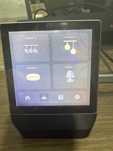

I really like your layout! Your latest update seems to have an issue with the navigation specifically in lights button. The lights seem to combine both a shutter and light that doesn’t seem to make sense. I can’t seem to be able to debug where this is pulling information from.
no, I just forgot to change the name )))
Where do I change the name?
Oh, I figured out the problem, I’ll fix it tomorrow evening. I won’t have time today.
Update: @PrayerfulDrop I fixed it, the thing is that substitutions have a single scope and shutter had exactly the same variable names as light and they overwrote them. Now I gave them names with a domain. So you can download it again with the latest commit.

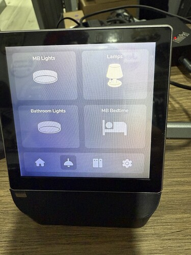

Did you get the connectors you needed to power the device from the board? If so, do you have a link to what you bought?

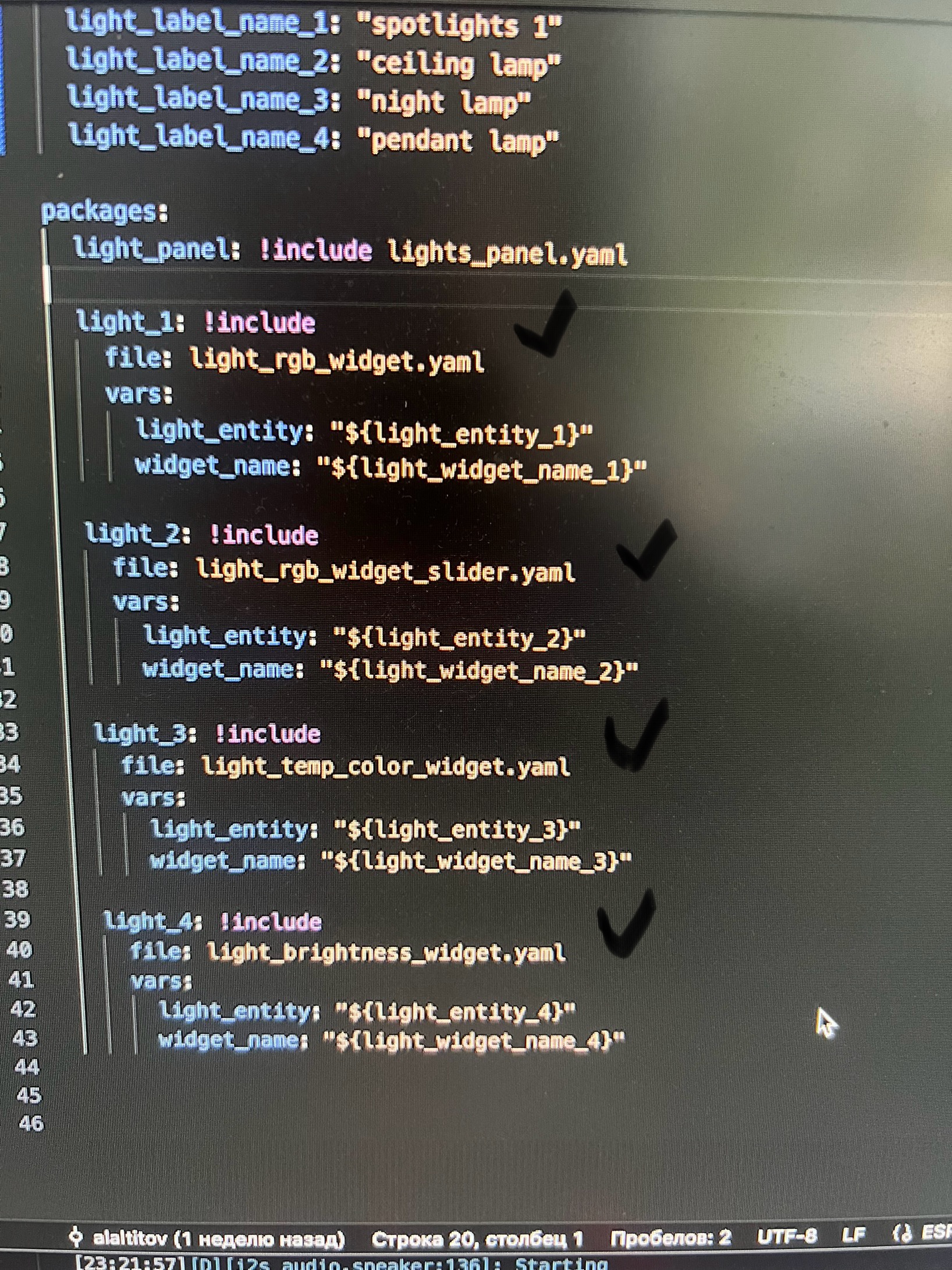

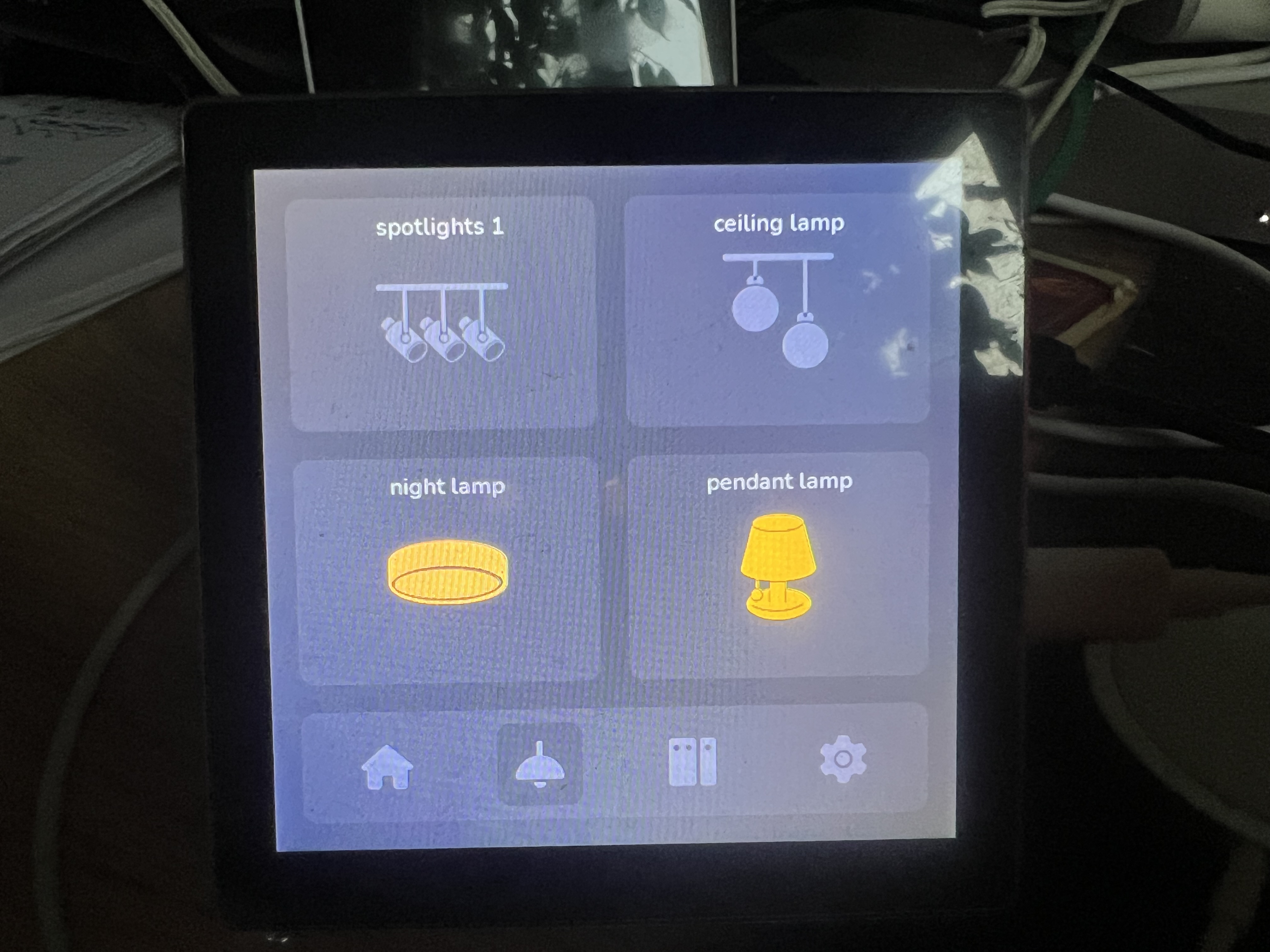

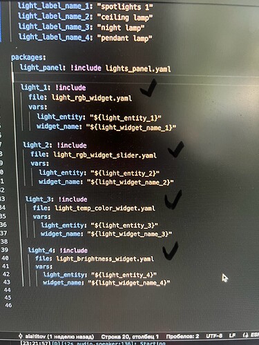

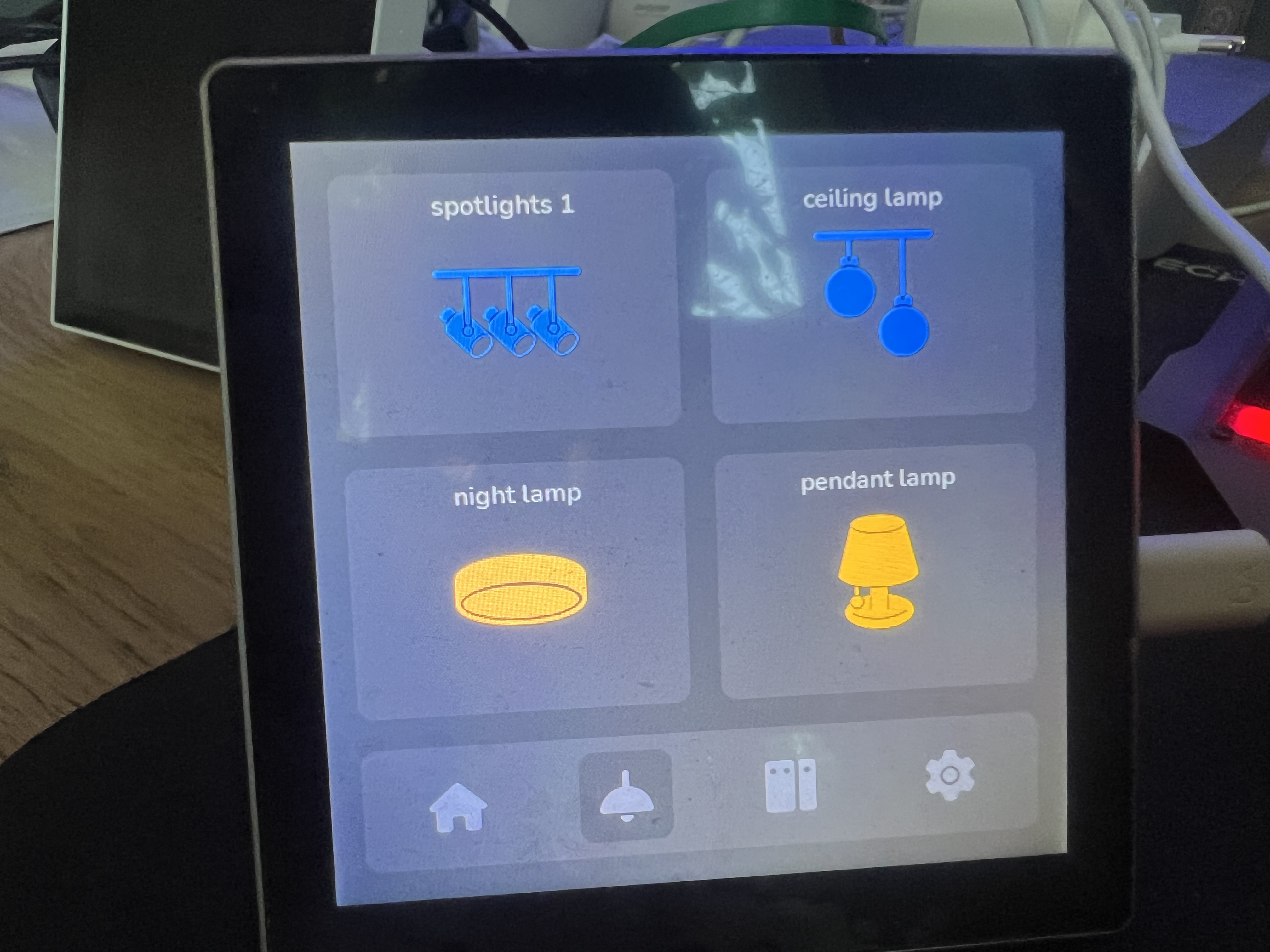

Everything is looking much better! One last question about the lights. The pendant lamp shows the status of the lights color on/off but the others will not. See picture for reference (all lights are currently on):
My edited version of lights_panel.yaml

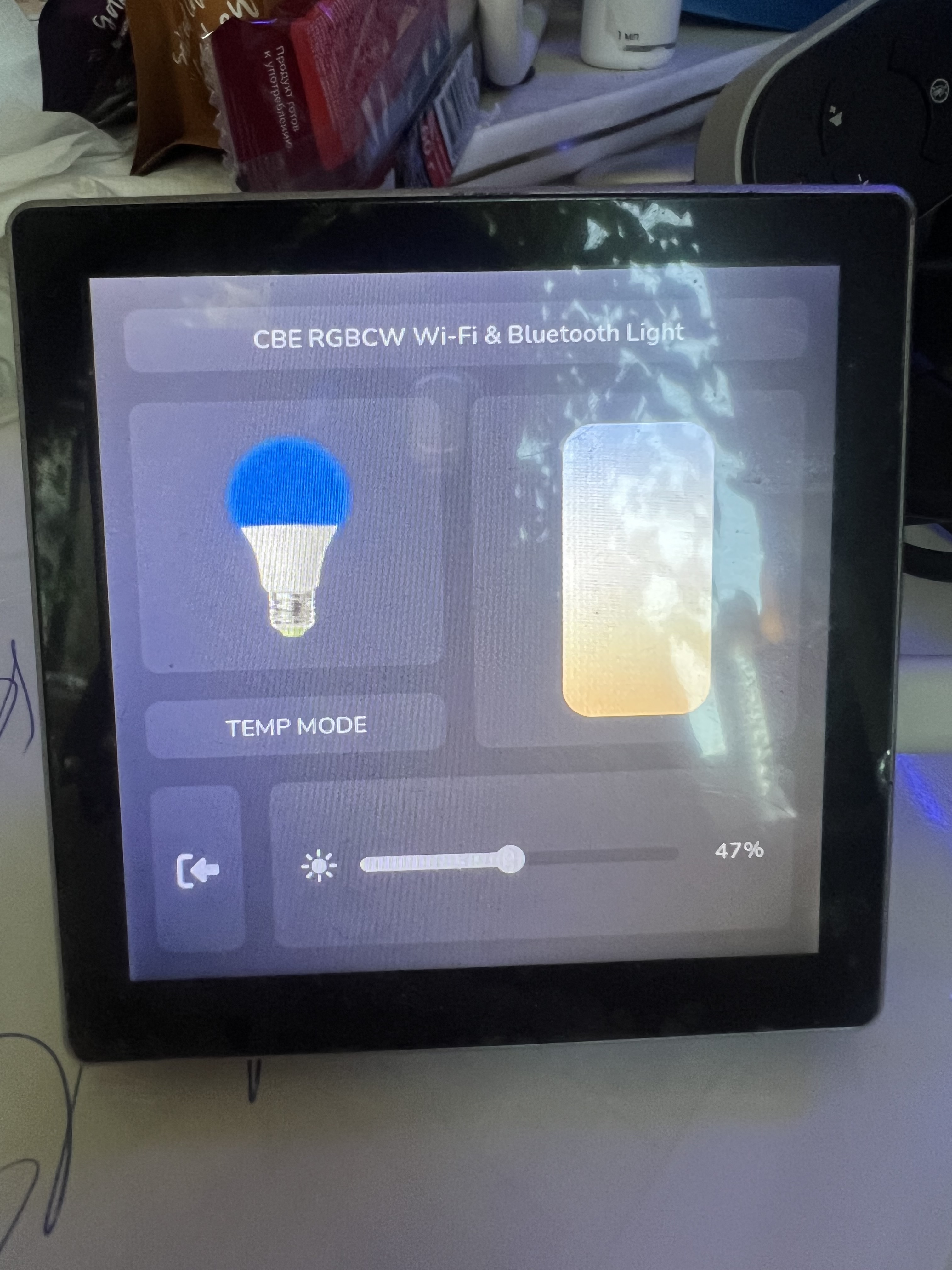

Because these are widgets for lamps with support for rgb light or temperature! If you hold your finger for 4 seconds on the button, you will open an additional control widget! And if your lamps only work on/off, then you need to use the usual state or brightness widgets. And connect the desired file as shown in the pictures.
Alrighty I have it figured out and it is working like a charm! Much appreciated btw!
