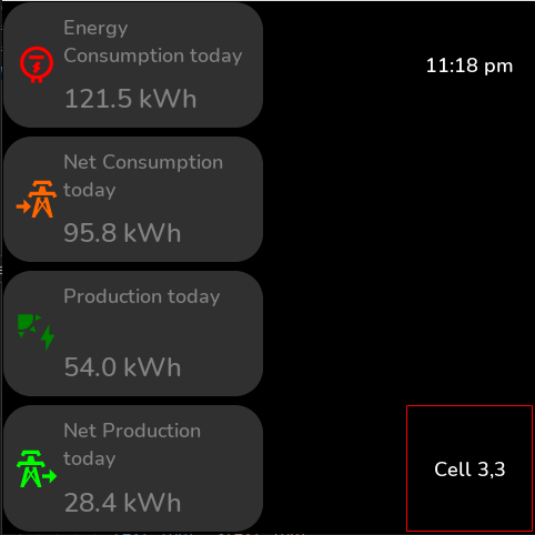

I just added a sensor button that can display data from a sensor info on a button. It also handles updating the button text from the sensor automatically.
Here is a demo that pulls solar data from HA and displays it.
