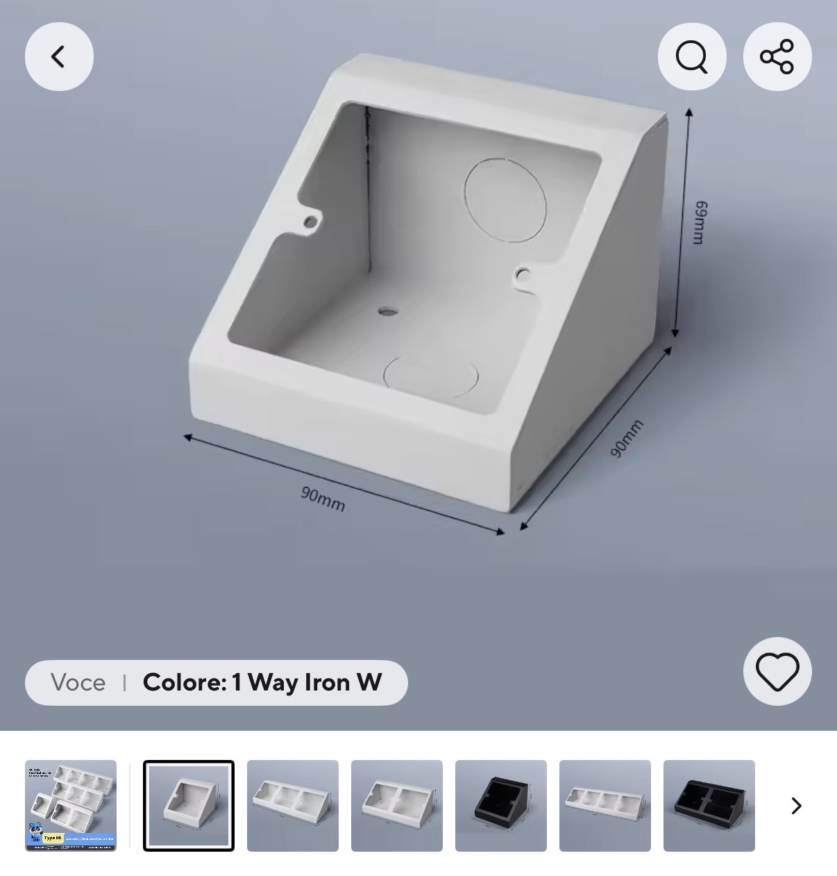

RE that desk stand: it's a pity that they didn't sink the display into the stand instead of putting it on top of it!
That would look a whole lot better IMHO...
what depth?
I imagine that yours has a rear relay anyway... because without a relay I don't think it's possible to fix it.
Maybe this is better:
it's cheaper to buy a 3D printer....
I intend to buy a Bambulab A1 Mini perfect for these purposes and it seems easy to use... I think it is now mandatory for these projects

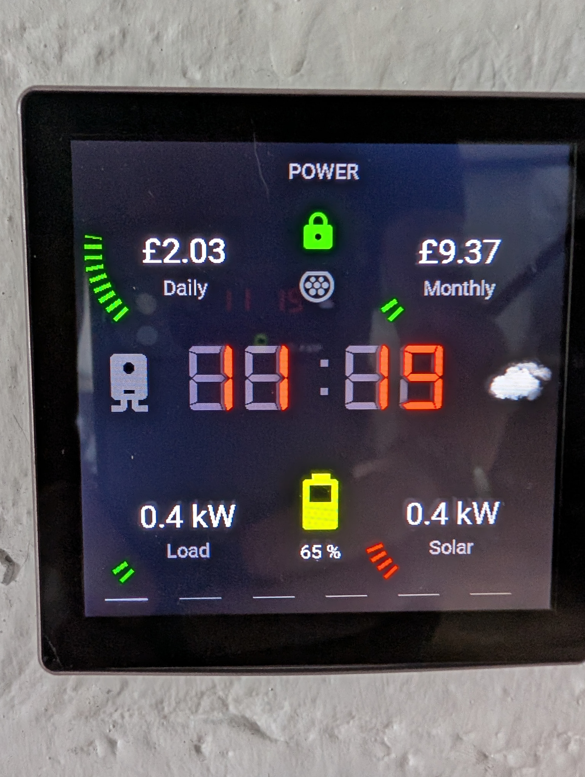

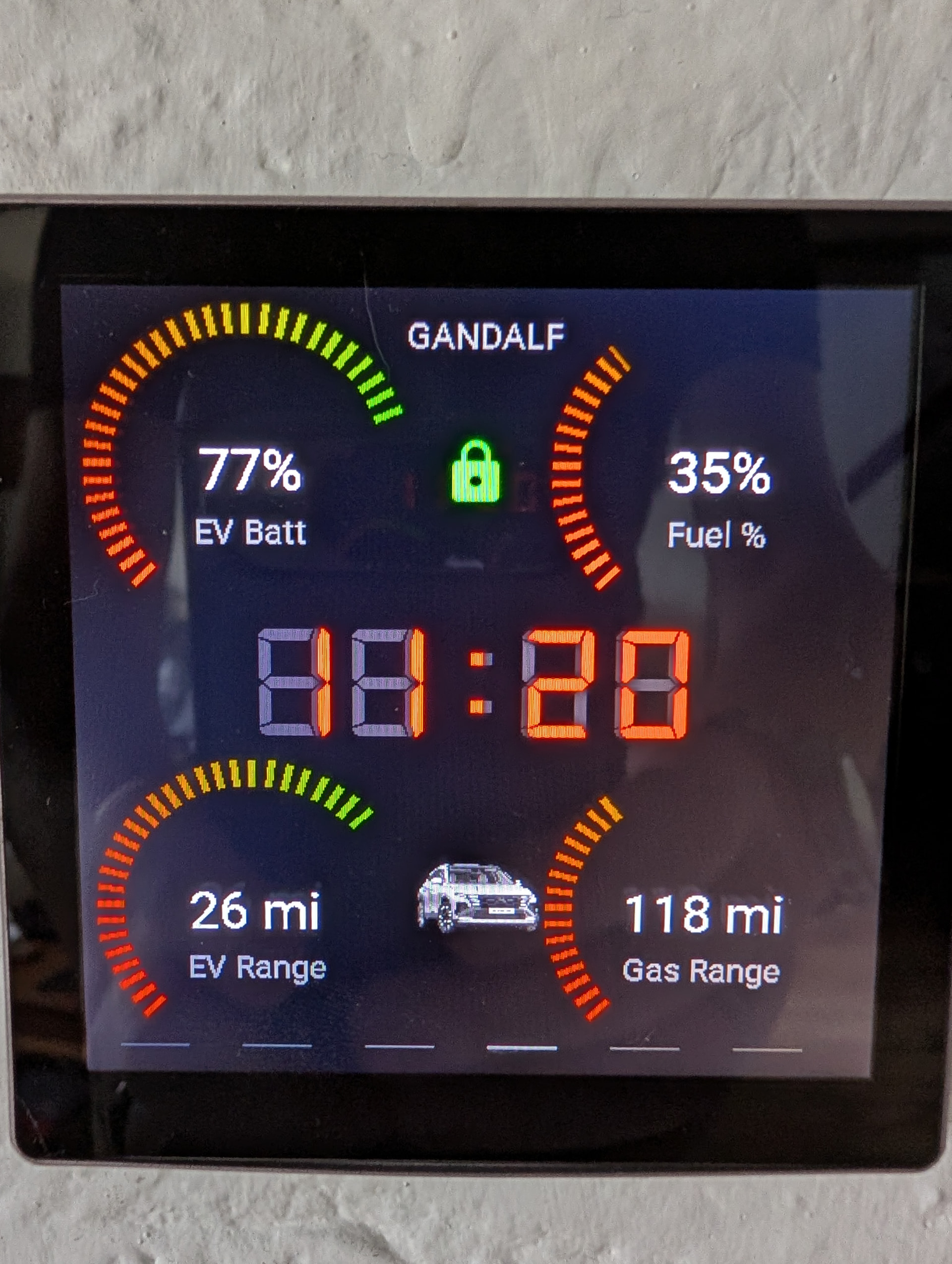

This is my screen - the actual individual screens are reactive, so when, for example the turntable is on, the Now Playing screen auto selects and shows the album and track playing on the record player :slight_smile:
There is also a screen for the logburner that tells you when to add more wood etc. but obviously that's not in use at this time of year!
You can lock the car and fire up the water heater as well by touching the required icons, which will react and change colour (red unlocked, green locked after car sends response).

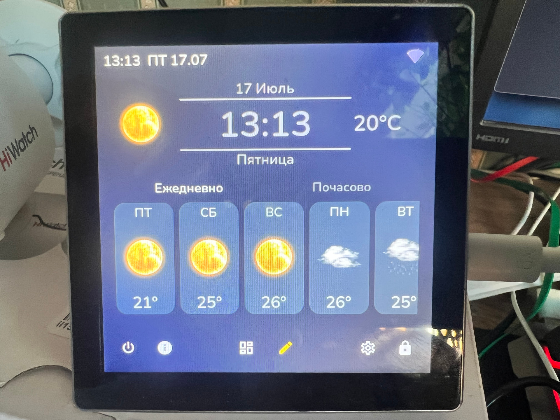

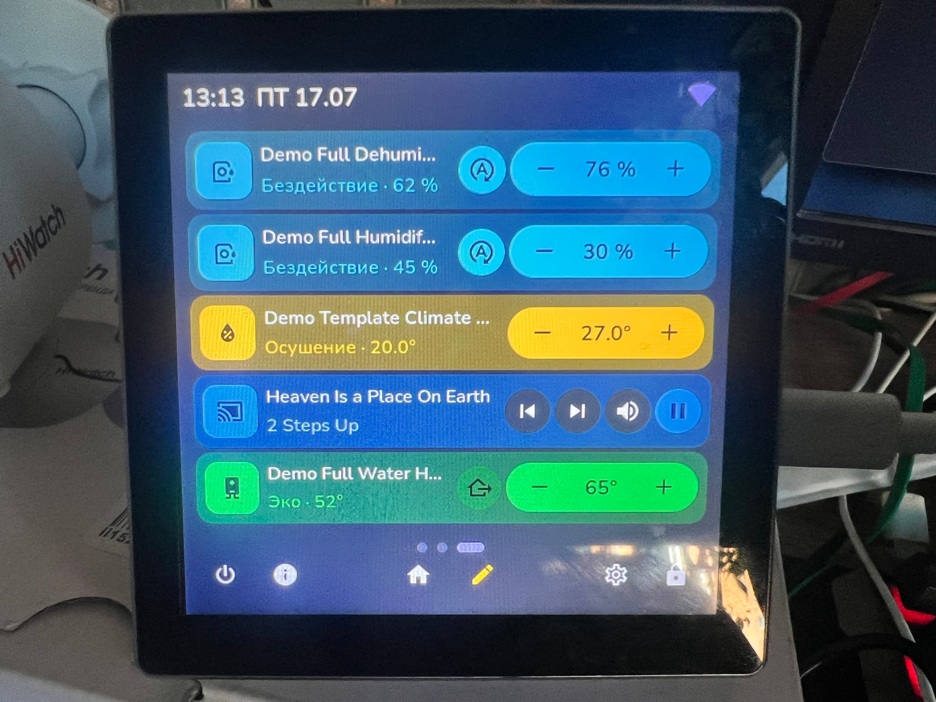

Hi everyone! Good news: the new firmware for the S3 version will be free and in a week or two will be available to everyone for beta testing. Why is it free for S3 but not for P4? It all comes down to device resources, primarily the small PSRAM: 8 MB versus 32 MB on P4. Plus other differences — RGB565 instead of RGB888, and so on.
Because of these limitations, it’s not possible to implement everything that’s on P4. The S3 version will have reduced graphics in extended cards, no camera video output, and possibly even no media player cover art (still not certain). There will be no voice assistant, and a few other things may be missing. The web server will remain the same as on P4, and the drag-and-drop mode will also be preserved.
Now about memory, to make it clear why we have to cut features. To keep the interface from turning into a slideshow, on S3 we hold three display framebuffers of 480Ɨ480 in RGB565 format (16 bits per pixel) in PSRAM — that’s roughly 1.35 MB. LVGL uses two additional line buffers on top of that. But the main memory hog is the need to copy fonts, arrays, and so on from Flash to PSRAM, otherwise everything will lag. That alone takes about 3 MB. Add weather icons, task stacks (which we are forced to place in PSRAM), fat buffers for the web server, Home Assistant, logs, and more — and almost nothing is left out of 8 MB. That’s exactly why I still can’t get even cover art running properly on S3 — we’ve hit the memory wall.
Nevertheless, for a device of this class and its cost, it will still be a very decent option. And for those who want more, there’s the paid firmware for P4.
