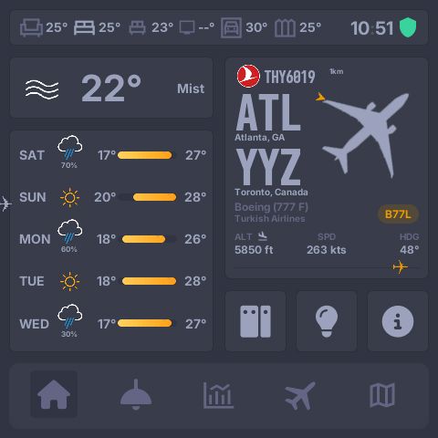

One (minor) thing i did notice though is in weather card: when i slide to left to see other days (or hours) whole thing goes to left but returns to “basic view” immediately - it doesn’t stay on right-most days (hours). I hope you know what i mean, otherwise i’ll try to record a video.
I’ll add this to the firmware with some other changes mid-week, thanks for your input!
