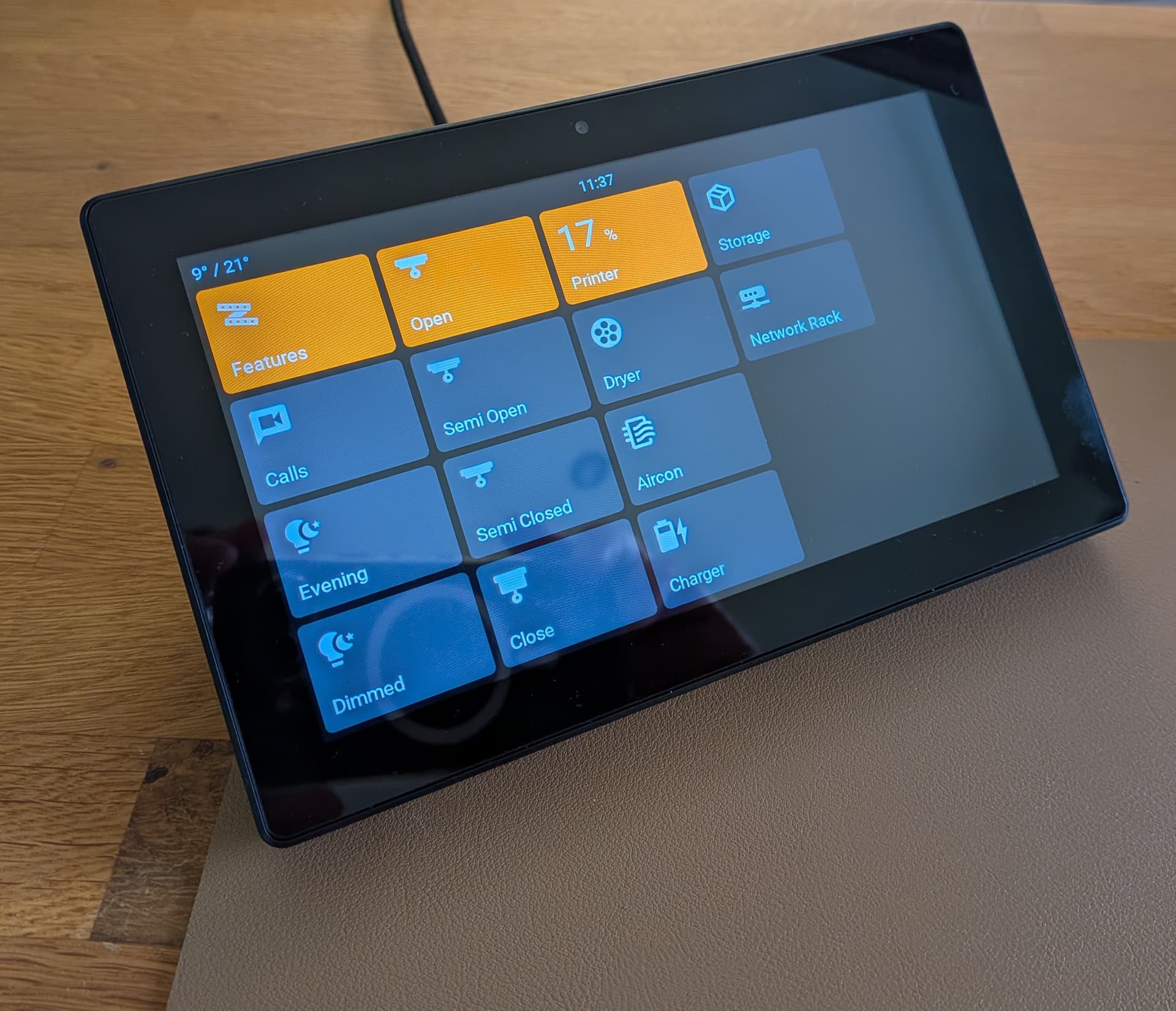

Searching around I found the new P4 based esp32 screens are a very reasonable price now, and good support from the community to get setup, so I thought I’d try out this Guition jc1060p470(£34/$50)
The performance leap from my old S3 panels is impressive, it’s both smoother on scroll and at higher resolution (whilst being the same price as my old screen!). The wifi reception is great and even has an camera and ethernet port (I don’t think it’s POE though)
I updated my old setup, to scale to this higher resolution, the code is here on Github, for anyone wanting to try out this setup.

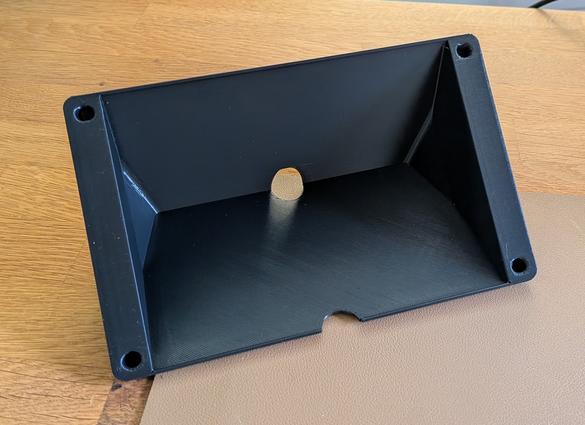

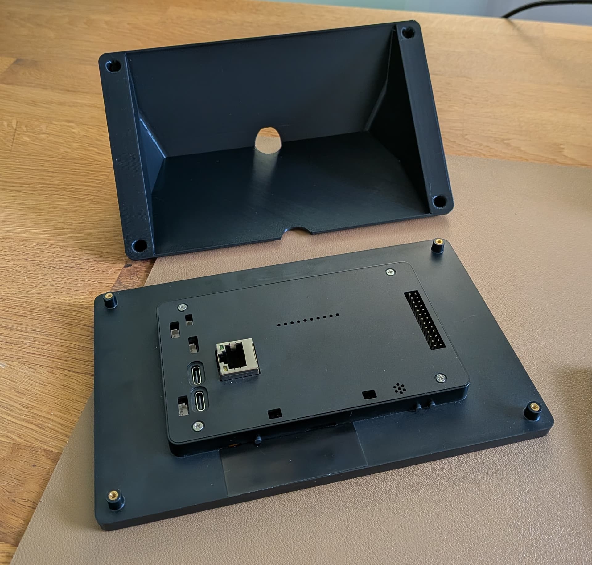

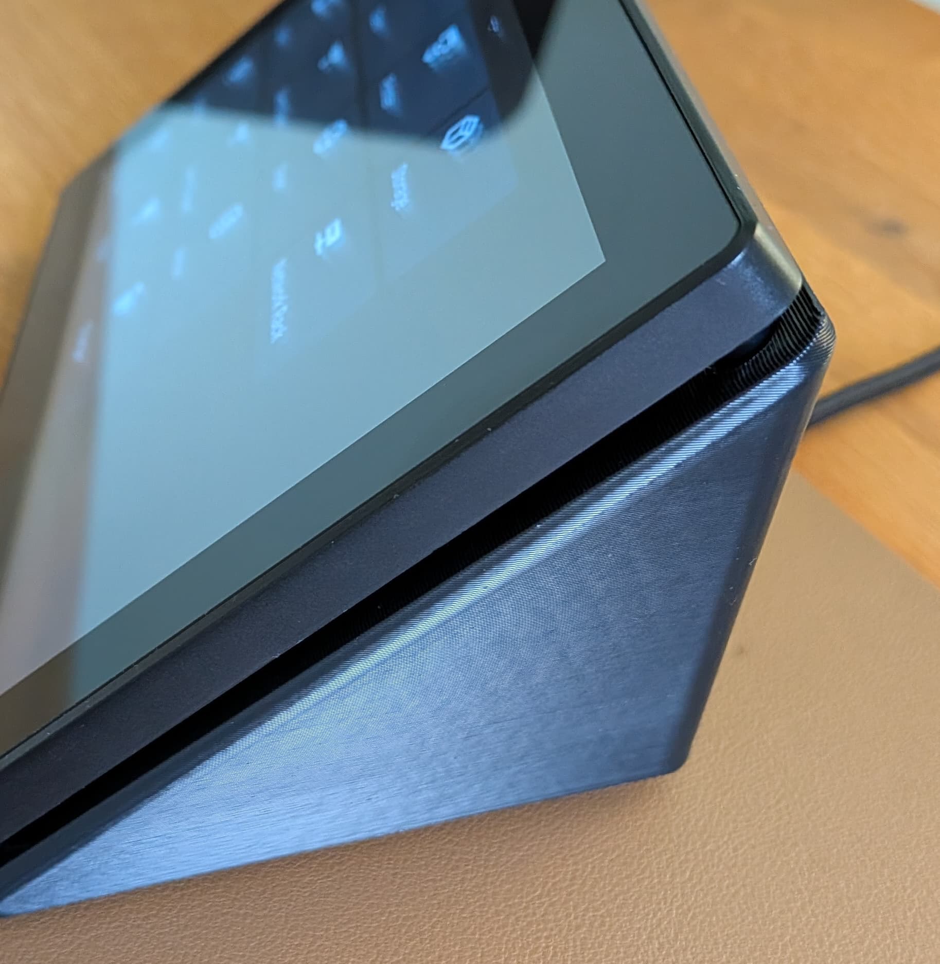

I designed a desk stand for it, where the posts just slot into the case. I recommend adding some rubber feet to stop it sliding too.
