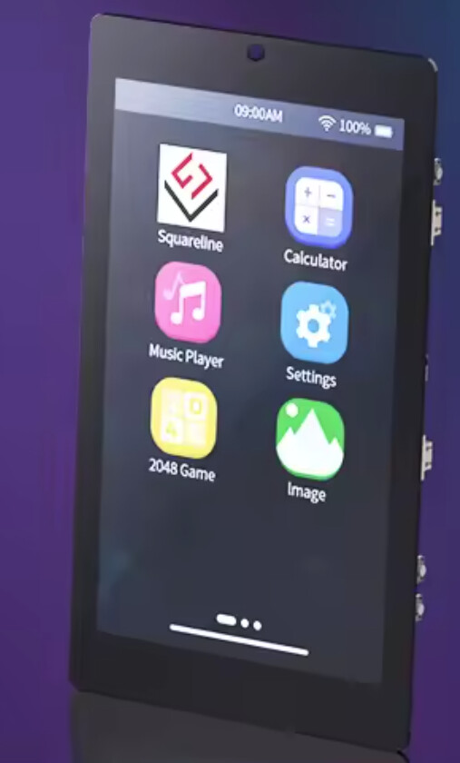

This is an amazing screen for $20!
ESP32-P4 HMI Series 4.3-inch IPS 480*800 high-definition LCD Display Module Capacitive Touch Panel with ESP32-P4NRW32 ESP32-C6-MINI-1U-N4 WIFI and Bluetooth 32M PSRAM 16M FLASH JC1060P470 Development in Arduino IDE, ESP IDE, Micropython, LVGL
Price: USD 34.99
https://www.aliexpress.com/item/3256809437179899.html
Says guition-esp32-p4-jc4880p443 on the back
P4 CPU (fast CPU)
Plenty of RAM + flash
Speaker and mic built in
tones of ports and extra I/O lines for peripherals
Only issue I have found so far is speaker and mic are on the same bus so it can’t listen for a micro wake word while playing music.
This config has the alexa micro-wake word and the new Sendspin media player preconfigured and enabled.
