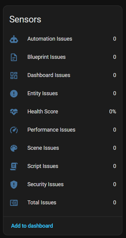

I just tried this out. I get all zeros for all the entities, even the score which I assume should be 100% if there are zero issues ?
After 60s the scan starts and all entities become unavailable, until I do a reload, then the same happens again after 60s. Also the same if I run the scan action.
I also get the same as above in the logs:
