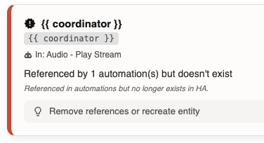

Looks like script variables are being flagged as missing / non-existent entities.
Thanks for your feedback.
Will be fixed in the last release.

  • Template variables misdetected as entities — Jinja templates are now ignored via entity ID validation

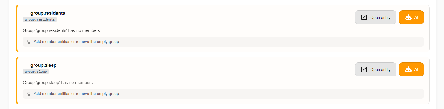

The only other issue I have at the moment is these errors that say there is nothing in the group, but the group is created in yaml and does in fact have entities. I would love to move them to the UI groups, but I can’t group person or input_boolean entities through the UI yet. Hopefully one day.
Will be fixed in the 1.7.0.

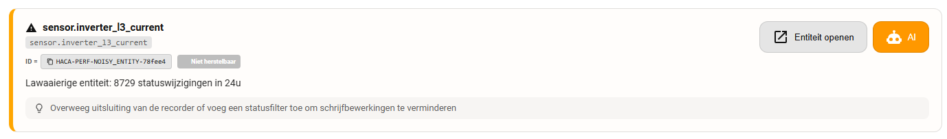

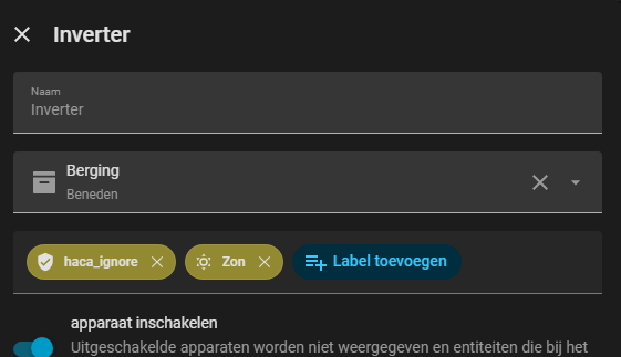

Just checked, I’m using 1.7.1. My solar panel / inverter is one device. I have added the haca_ignore label to that. But the individual entities show up with the performance tab.
Inside of HACA:
Ok. Will fix that in the 1.7.2.
