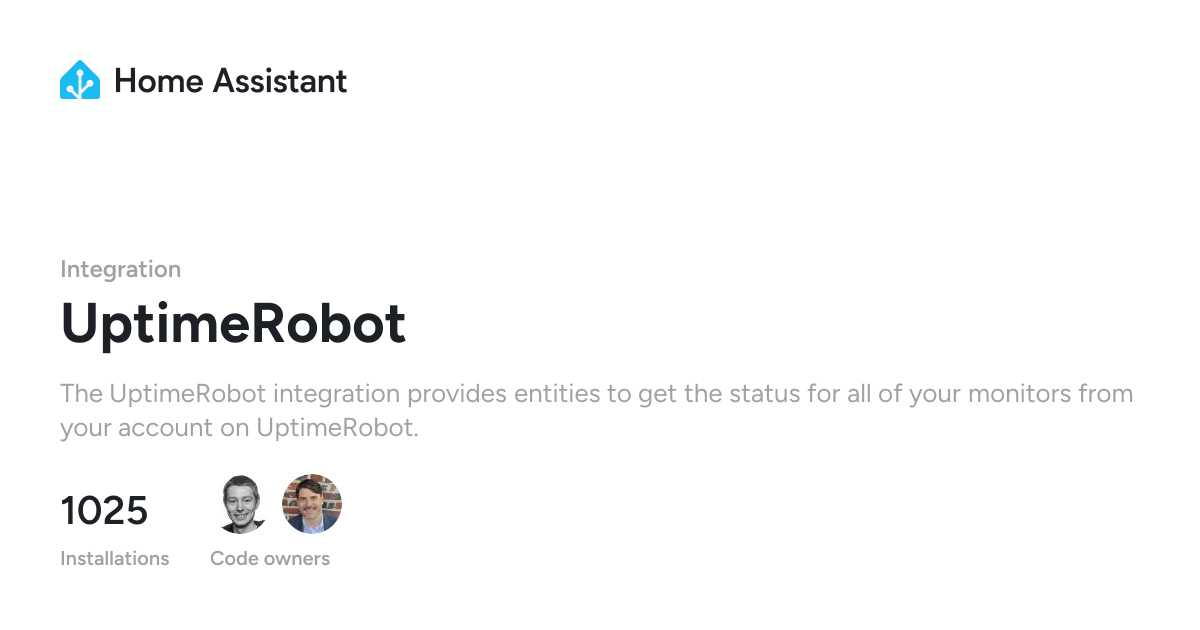

Not sure if it is "the best", but you could try https://uptimerobot.com/
Or Uptimekuma? https://uptimekuma.org/
