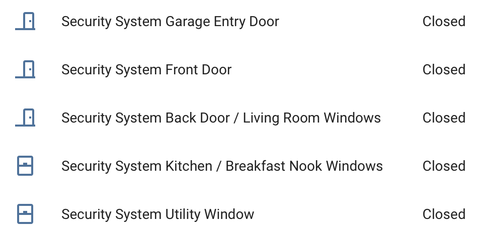

I understand the change, and for the most part, I agree with it.
However, I have an ESPHome based security system that I made years ago before Konnected.io was available. Now every entity has a “Security System ” for the frontend name. The change seems to assume that each ESPHome device only covers a single area.
This makes the integration more confusing as each entity needs to have a name override.

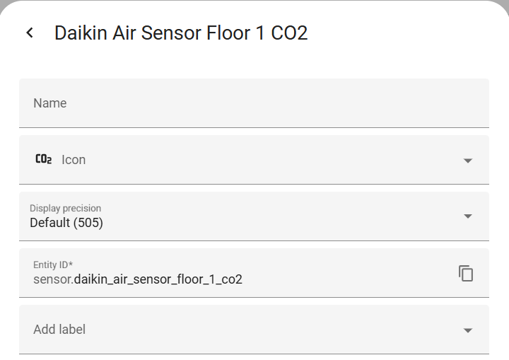

Alright about the ids it is clear. I never changed the on-boading names in Home Assistant. Example:
This entity:
is defined in ESPHome as

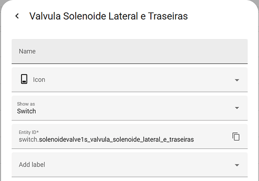

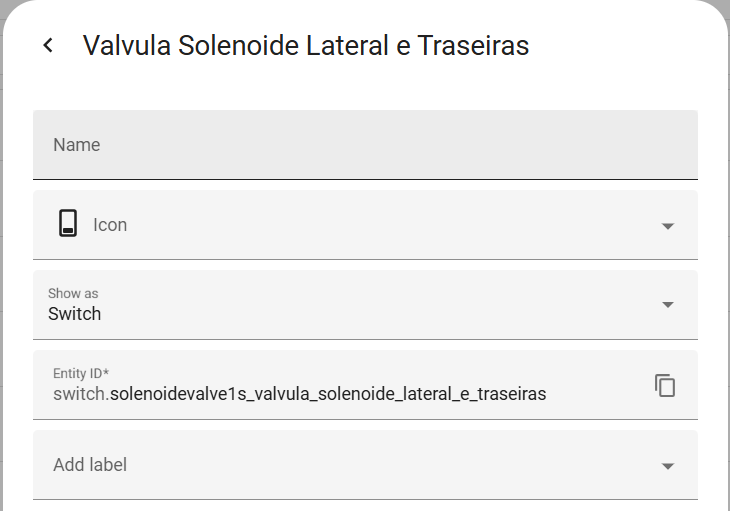

another example:
esphome:
  friendly_name: Valvula Solenoide Lateral e Traseiras

As you can see I’ve never gave names is HA and if it is possible I would like to keep that approach even that I have to change all the ESPHome devices fw.
In short my question is what changed is needed in the ESPHome yaml to keep the actual names?
