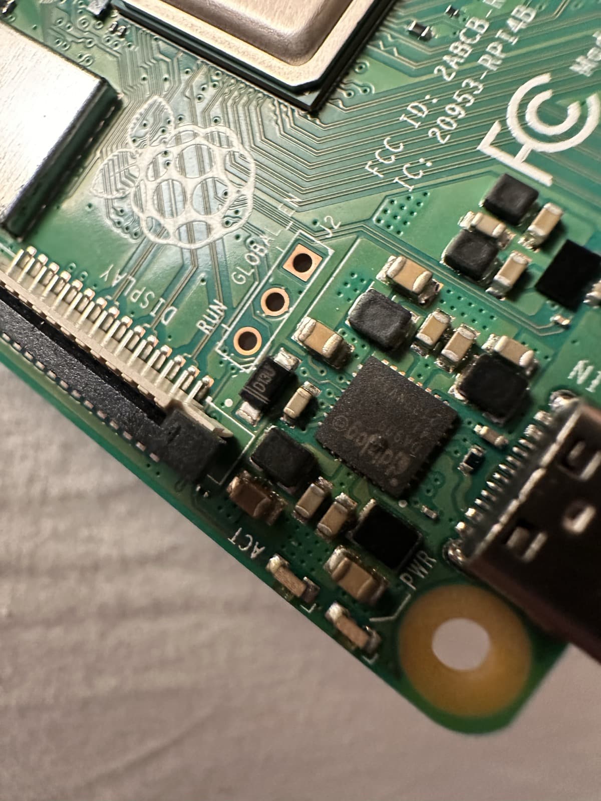

I return to it this afternoon and on inspection find that the case has melted around the power connection and that the “Dialog” chip near the USB-C power connection appears blistered, I get the impression that the chip got fried at some point during this whole process. Pictures are included below:
(I’m a new user so I can’t post a second image of the melted plastic case, but it’s melted in the area around where the chip is, not where the USB-C power is)

Random hardware failure is random.
You failed to install the cool app update on April 1! Seriously, a software initiated hardware failure is rare, and blaming a software update when millions of other Raspberry Pi’s have successfully updated is a very long bow to draw. Attempting repair is uneconomical, even if you could source the individual parts, the internal PCB layers are most likely damaged. Accept fatality is final. Move on.
Commiserations, and possibly a cooling fan or heatsink for your next incarnation.
Check your UGREEN USB-C charger power supply voltage before you plug it into something else. It may have been affected or the cause of your woes. The signs that the Pi was on the way out were already there when tasks became unresponsive.
