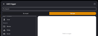

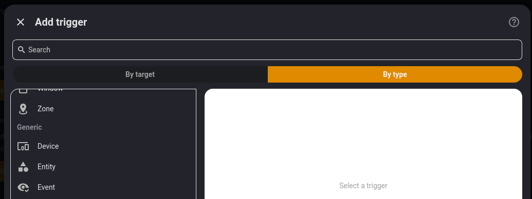

This is likely what you were using previously. It’s not front-and-center in the new trigger selector like it used to be, but it is still available. Using the search bar with “Device” as your search term is the easiest way to get to the correct trigger.
If you really want to click it manually, you’ll need to click on the “By type” tab, then scroll down to the “Generic” subsection:
