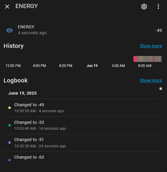

YAML attempt:
mqtt:
  sensor:
    - name: "ENERGY"
      state_topic: "tele/SonoffESP32/SENSOR"
      value_template: "{{ value_json['ENERGY'].Power[1]}}"
      unique_id: "ESPSolarMeterPower0"
HomeAssistant_MQTT integration_Configure_Listen to topic:

I just recognized that what seemed to be total failure might be partial success.
as you see below the logbook indicated received data. The entity always show unavailable status. also other entities do no show a log and I can’t seem to get data into a meaningful graph on the dashboard
OK just added the option “unit of measure” and I have a nice graph and option to add as card. I think I am getting my head around this now :wink:
I think i’ve mostly solved it;
besides figuring out the correct topics and syntax the undocumented part was the needed brackets in the json data, e.g. power[0] and power[1].
