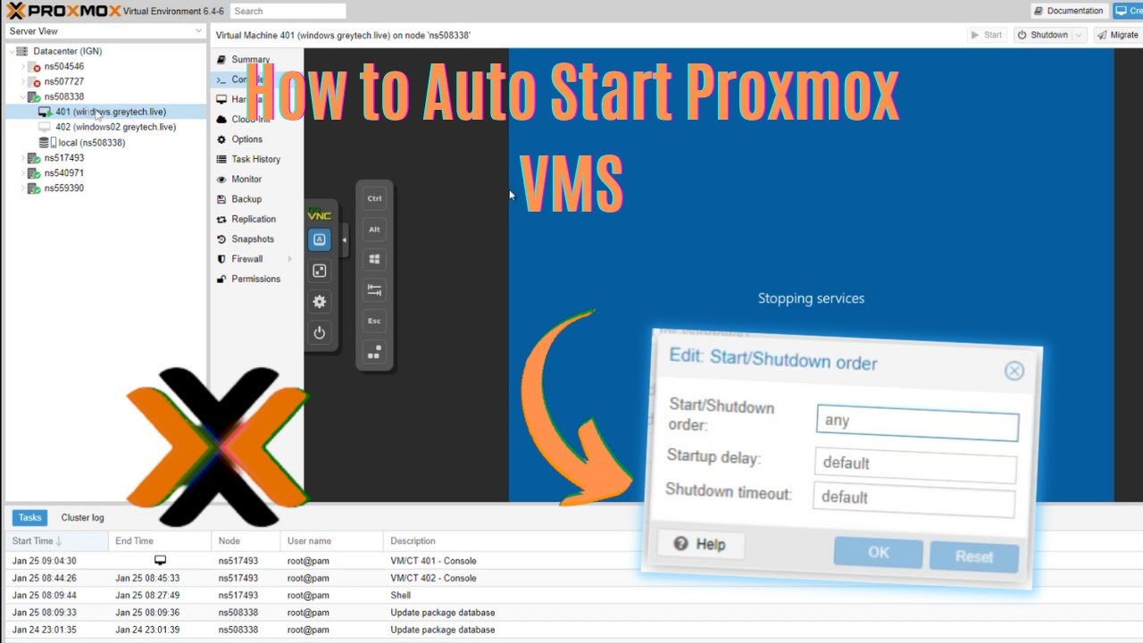

Did you make sure to enable the VM to start automatically when Proxmox starts up?
