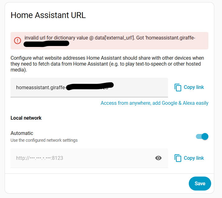

I have configured Tailscale and I can now access my instance of HA when away from home by entering the URL that Tailscale gave me in a browser. Is it possible to also access it through the companion app?
It gives me the option to open settings, so I then tried to add a server and enter the address manually (using the tailscale provided url), it gives me a message:
“the mobile app integration is required to use the app, but it is not avalable on you Home Assistant Server”. What does that mean? I tried to add the mobile app integration to my home instance of HA, but I then get a pop up saying:
" Open the mobile app to set up the integration with Home Assistant. See documents for a list of compatible apps.".
It is just going around in circles. Am I doing something wrong, or is this not possible?

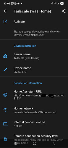

Thanks. I had already installed the companion app and my mobile device is there (SM-S931U). But I’m not sure where to edit the app external URL. I went to Settings, System, Network and tried adding it here, but got the following error:
I tried it with \ and also http prefix, but no joy. Should I remove and reinstall the companion app?

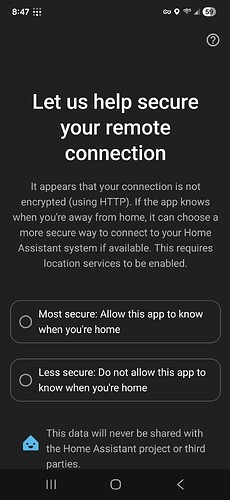

Roger that. I was able to add it following your instructions. Once I entered my credentials, the following screen came up:
I clicked “most secure” and it is connecting with wifi turned off. Yay! I’m hoping this will also fix the automation that I had created that was based on entering my home zone.

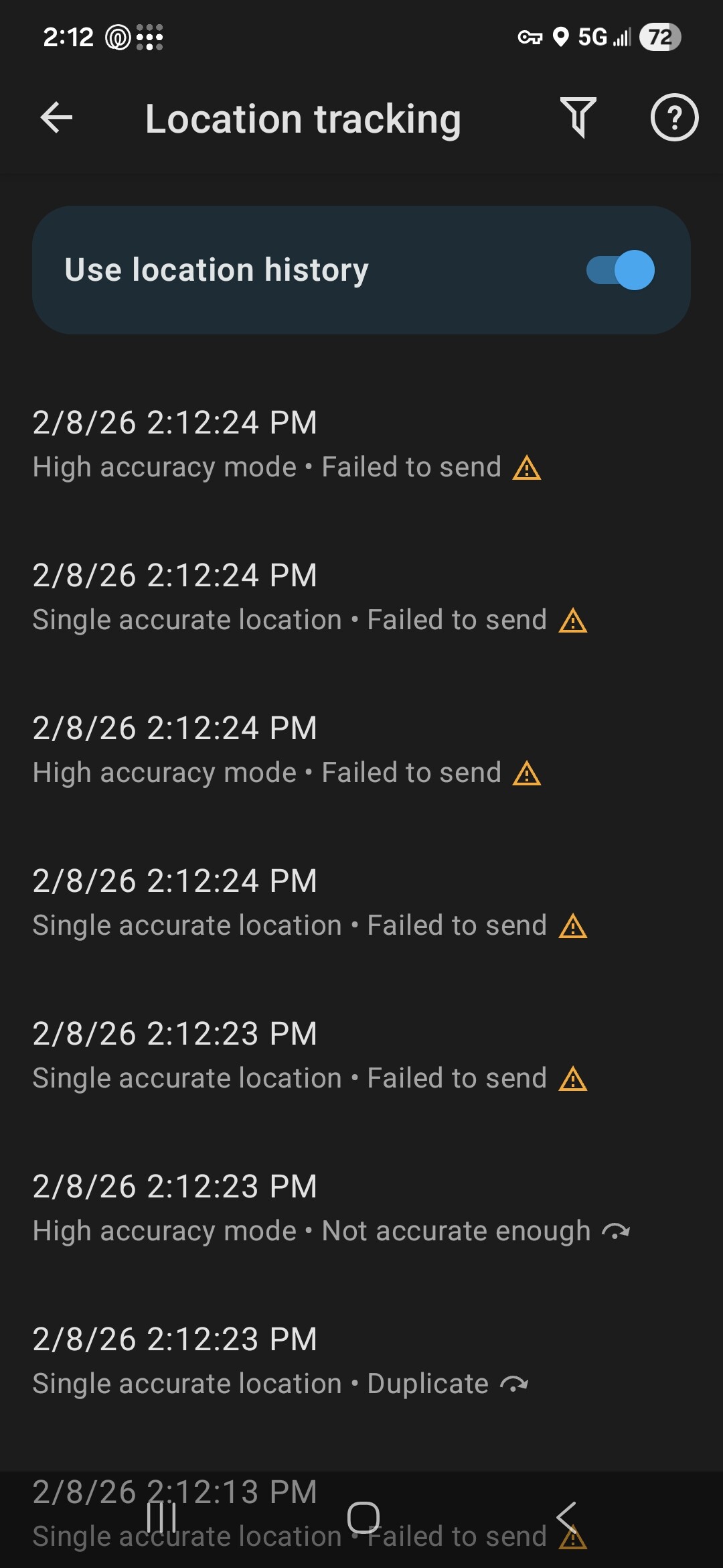

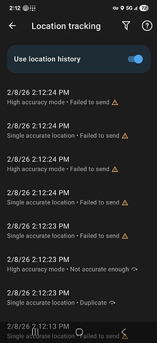

Remote access is still working, so thanks again! I have one more related question (but I can post a new thread, if you think I should). I cannot get Tailscale to update my location (home vs away zone). I have given the companion app all permissions and enabled high accuracy.
I can see my postion being updated within about 5 seconds when on wifi, but not when I turn it off. Even after a few minutes. And as mentioned earlier, I can access my HA instance when wifi is off. Here you can see I have funneliing enabled. Is ther anything obvious you can think of?

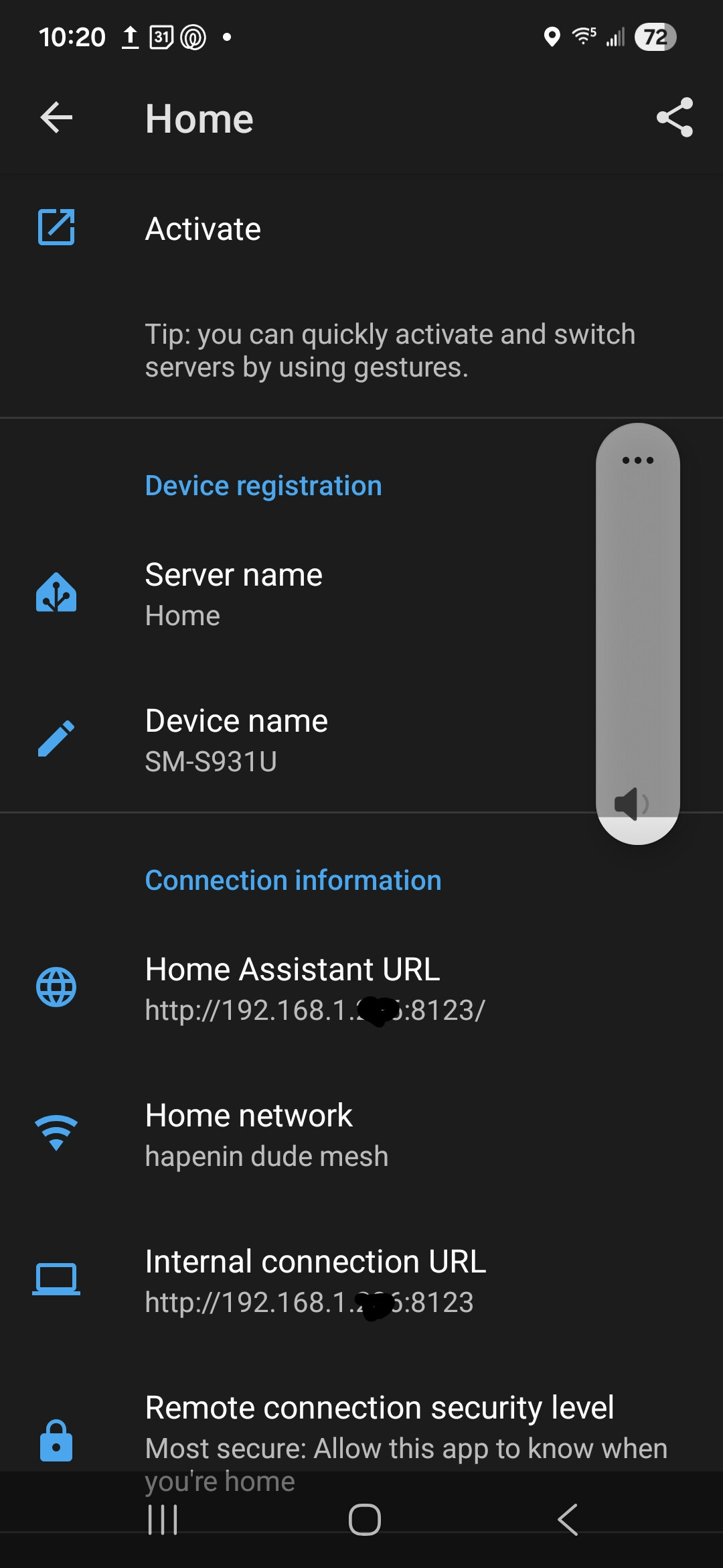

  2. Can you share your screen of this page? The External URL should be the same as above, but there are other settings.

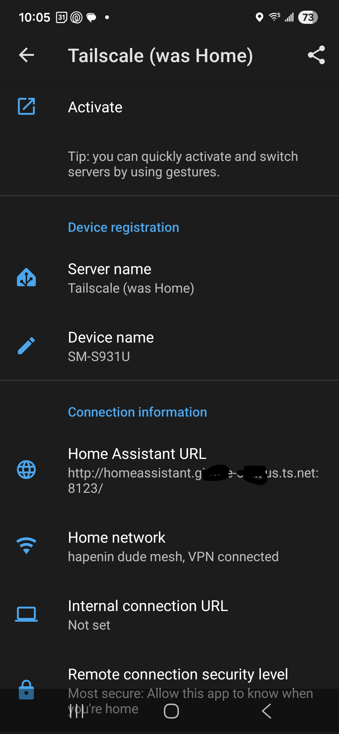

I think this is the screen shot you wanted. I have two devices. Here is the first:
I tried setting the internal url the same as external but it still didn’t work.

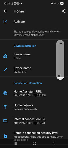

And here is the other (for the phone, I suppose):
I don’t know why they both have the same device name, maybe it doesn’t matter.

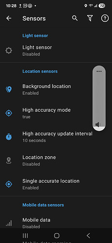

Here is the Location sensors screen shot:
I tried all sorts of variations of these settings, both enabled and disabled. Nothing helped. This is what the troubleshooting screen looks like (for comparison, when on wifi, it would show sent):

  • Now go back to the HA Companion app, pick one server profile.
    . Under the Home Assistant URL, let’s use http://100.xxx.yyy.zzz:8123
    . The Home network should be the SSID in your house. The companion app would know your are home, when the phone is connected to this SSID. And I hope the name would not change throughout the house.
    . The Internal connection URL would be http://192.168.1.zzz:8123
    . The Remote connection security level: let’s use “Less secure” for now, since we are not using https anywhere.
    . I have enabled all 3 toggles under the Security section of the server profile
    . Don’t know if this matters, but I do “Always” under the Persistent connection.

Good question, sorry for the confusion. I think I should have used the term machines, but nevertheless, I have one phone and one instance of HA.
  1. Hmm, I wonder how I got two server profiles.
  2. With no wifi and tailscale started, I can access HA from the mobile browser using only by using xxx.yyy.zzz:8123, but not if I include http://100. in front of the xxx.yyy.zzz:8123. Actually, I think I misled you regarding the format of my tailscale provided IP. I should have typed it as homeassistant.xxx-yyy.ab.net:8123. That is the format I enter in my browser and I can access HA.
  3. I picked the server named tailscale.
  • In the format you suggested, for the home assistant URL, I used http://100.xxx-yyy.ab.net:8123. (see NOTE 1 below)
  • The home network shows the SSID of my house follwed by a comma and “VPN connected”. Fortuantely, I have only one netowork in my house.
  • For the Internal connection URL, I entered http://192.168.1.ab.net:8123 thinking zzz in your example was the last part of my HA URL (didn’t work - see NOTE 2 below)
  • I used Less Secure for the security level
  • I turned on all 3 toggles in the securiy section
  • I turned on Always in the persistent connection

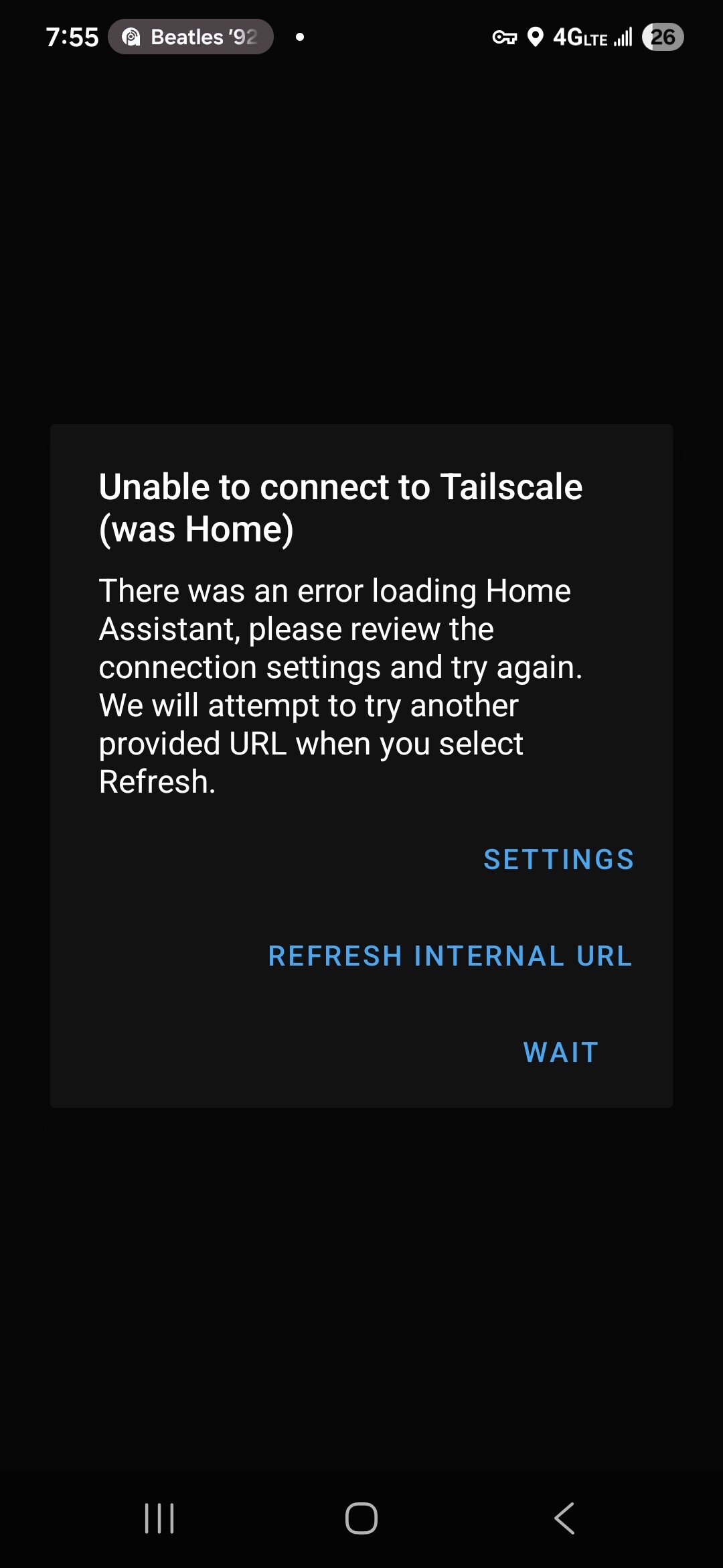

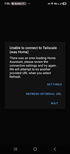

It still takes me to the screen that says my server settings are wrong:
But the odd thing is that even though it doesn’t connect, and I get a blank screen for 4 or 5 seconds before the above screen pops up, I do get an Android notification “Connected to Home Assistant”. So I think we are making progress!

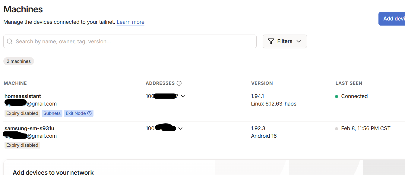

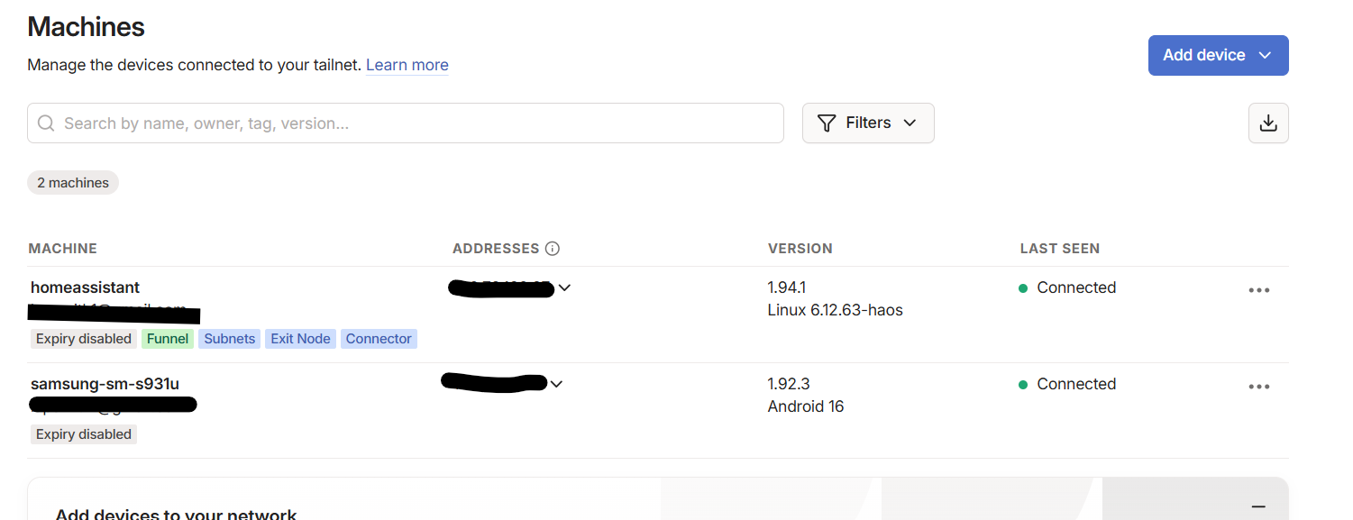

Lastly, do you think I should delete the second server profile? I assume that is not the same thing as Machines in the Tailscale admin page. In the other profile, the Home Assistant URL and the Internal Connection URL are both my internal IP address for HA .
