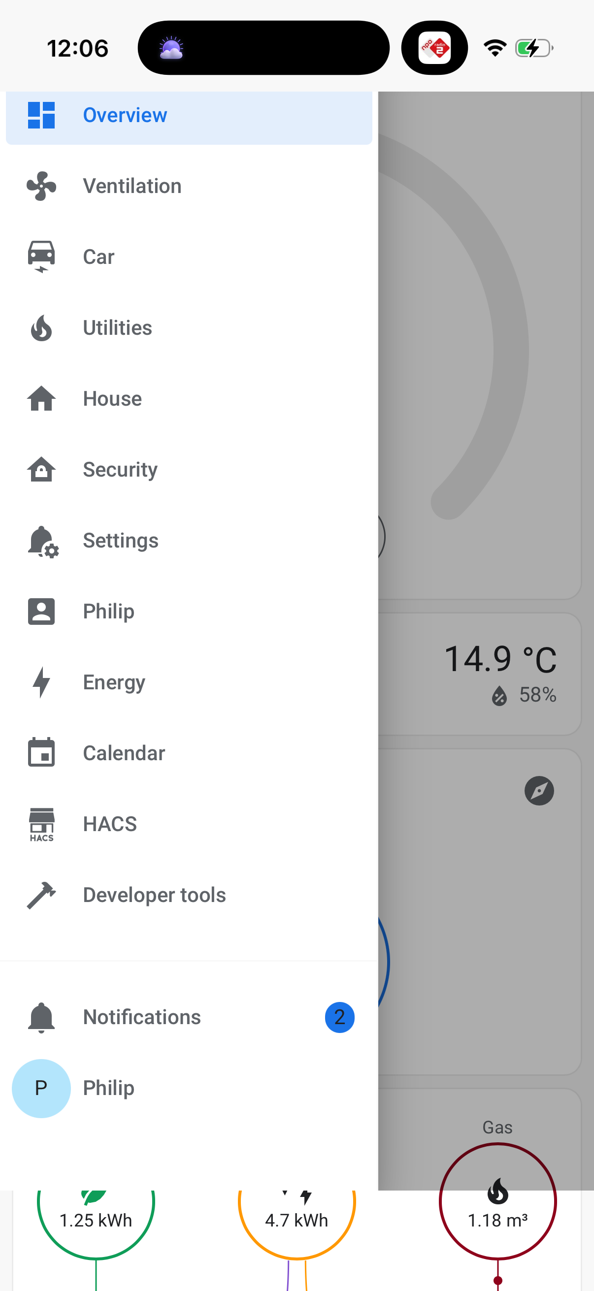

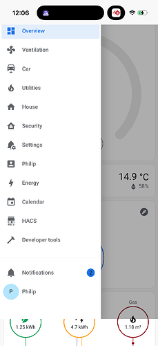

When I scroll up and down in custom lovelace dashboard, energy dashboard and settings, the header (with hamburger button and 3 dots etc) disappears up the page. These header elements used to stay at top of the screen, always available.
When having the left menu bar open, scrolling action seems to scroll the menu bar half way up the page.

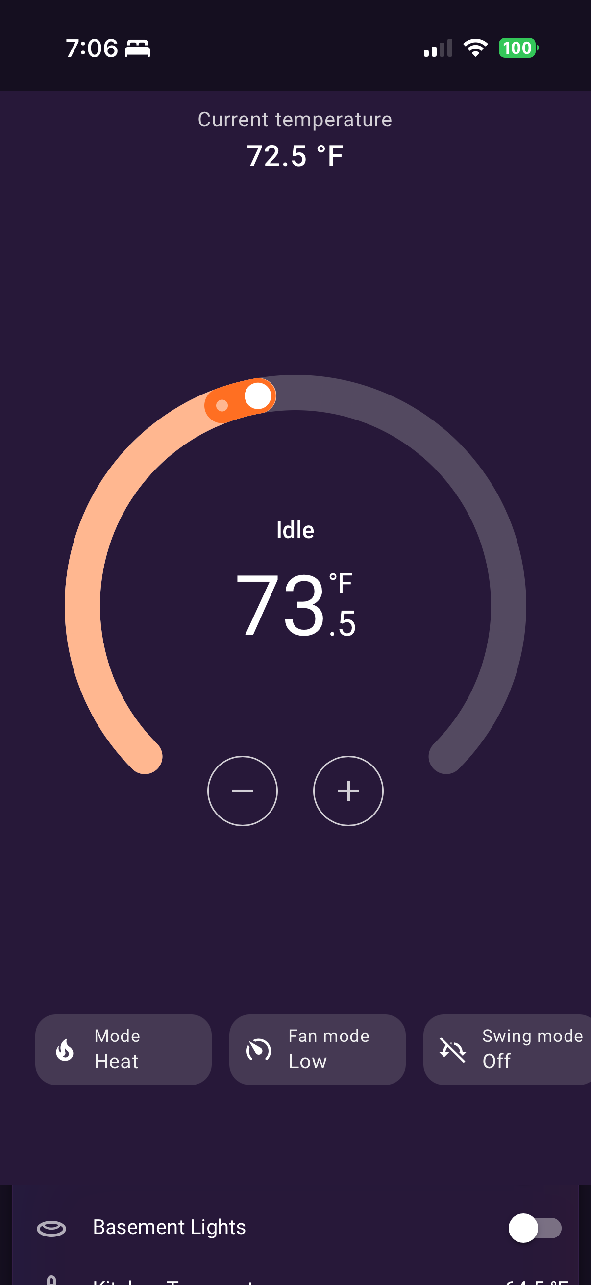

Then when I press on an entity more-info screen, it is half way up the page, having to scroll up to see all of it.
The more-info screen used to take up the whole screen regardless of my current scroll position in the dashboard.
