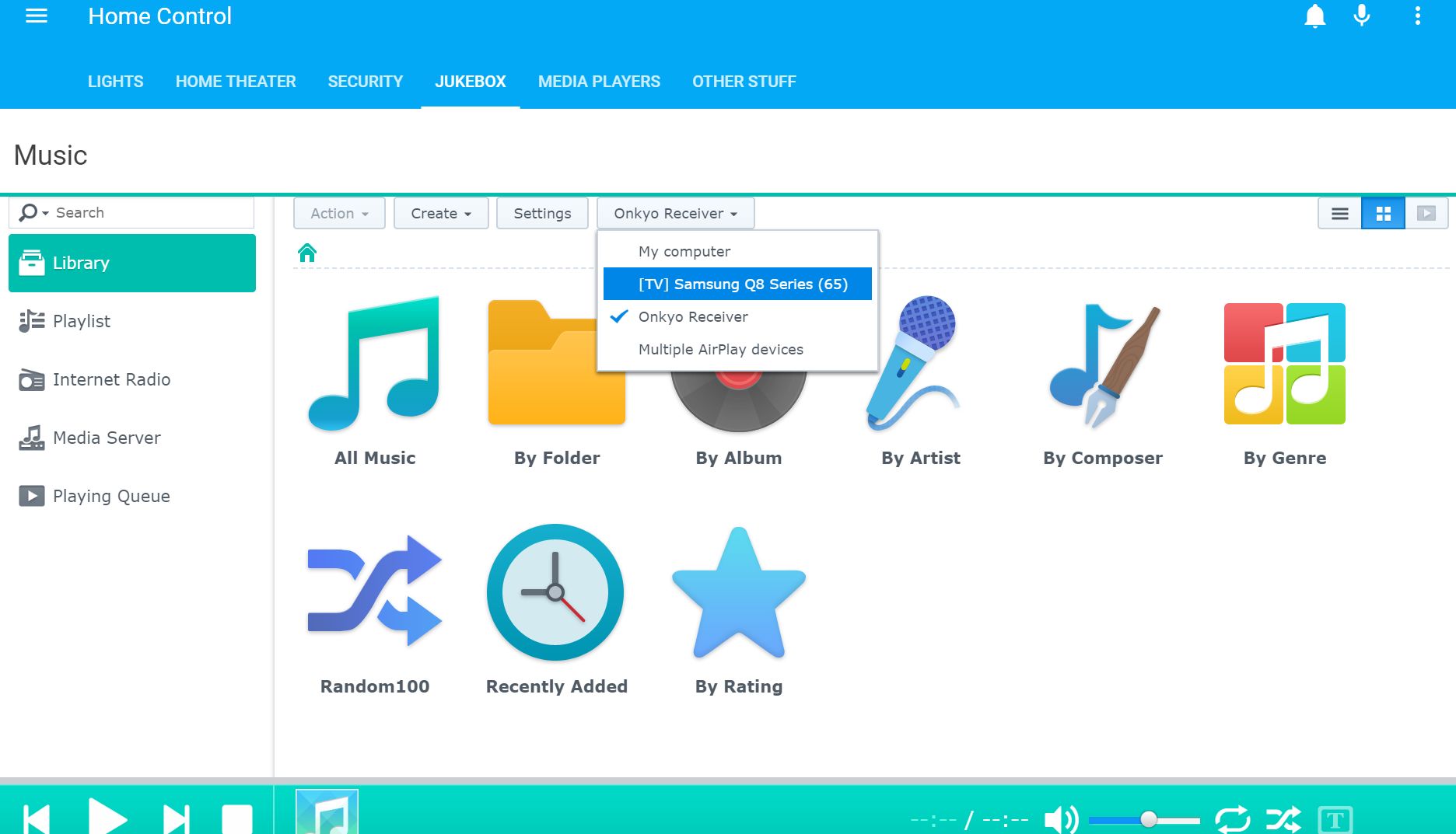

I was able to install Audio Station on my Synology and configure the permissions to allow HA to access without a password. I then embedded the Audio Station within an iframe in Lovelace and set the view to panel mode.
I can browse my entire music library by category or use the search feature. When I begin playback, it changes my Onkyo receiver to the proper input and begins playing the music over my primary home stereo system. As of now, the available options are limited to what the Synology Audio station detects (e.g. Airplay devices), but I have gotten it to stream to the Onkyo DLNA service. Right now, I don’t know how to add devices/capabilities to the Audio Station options, but to be honest, I haven’t tried. My goal was to stream to my primary home theater receiver anyway.
Hope this helps someone. I hadn’t found any other information on streaming from my Synology to devices via HA… other than Internet radio.

There really isn’t anything tricky to this process. First, assure that Audio Station is installed and configured properly. You should be able to access Audio Station directly in a browser by navigating to http://yourSynologyIP/audio/. If this doesn’t work, you won’t be able to embed in Home Assistant. See the Synology documentation for installing/configuring Audio Station. Check that you have permissions set properly to access Audio Station directly from a browser on a computer.
There is one change you need to make. Within DSM->Security, clear the checkbox that says “Do not allow DSM to be embedded within iFrame”.
From there, you simply create a tab (view) in Home Assistant Lovelace. Add an iFrame (web page card):
> aspect_ratio: 50%
> title: Music
> type: iframe
> url: 'http://*my_synology_ip*/audio/'
Change the property of the view to ‘Panel mode’ to show Audio Station ‘full screen’. That’s all there is to it. One drawback is that you must login to DSM/Audio Station within the iFrame on occasion. I haven’t investigated a way to either auto-login or to keep the login alive, but for me, that’s no big deal. As long as I’m using the ‘Jukebox’ view in Home Assistant, I stay logged in. It’s only after I navigate away for a while that am I prompted to log in again.
