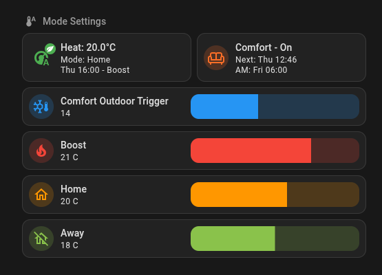

Boost mode is implemented as a one of the heating modes, configurable through the dashboard and set in the schedule / overridden by the heating watchdog automation and a morning "boost" based on phone alarms and outdoor temps etc.
The "Comfort Mode" switch controls whether anything can override the heating schedule.
Dashboard items should help explain:

                  state: "off"
                - condition: state
                  entity_id: binary_sensor.house_occupied
                  state: "on"
                - condition: state
                  entity_id: input_boolean.heating_comfort_mode
                  state: "on"
                - condition: not
                  conditions:
                    - condition: state
                      entity_id: schedule.tado_heating_schedule
                      attribute: mode
                      state: "night"
                - condition: numeric_state
                  entity_id: sensor.house_temperature_mean
                  value_template: "{{ (state.state | float(21.0)) - 0.5 }}"
                  below: input_number.heating_boost_temp
                  entity_id: climate.thermostat
                  attribute: current_temperature
                  entity_id:
                    - sensor.composite_feels_like_temperature
                    - sensor.decking_multisensor_temperature
                  below: input_number.heating_outdoor_trigger_temp
  actions:
    - variables:
        heating_mode: >-
          {%- if is_state('input_boolean.holiday_mode', 'on') or is_state('binary_sensor.family_wfo', 'on') or (states('sensor.proximity_home_family_miles')|float(0) >= 20) -%}away
          {%- elif is_state('input_boolean.holiday_mode', 'off') and is_state('input_boolean.heating_comfort_mode', 'on') -%}boost
          {%- else -%}home
          {%- endif -%}
        temp_set: "{{ states('input_number.heating_foo_temp' | replace('foo', heating_mode)) }}"
        temp_default: >-
          {%- if heating_mode in ['away','night'] -%}18
          {%- elif heating_mode == 'home' -%}20
          {%- else -%}21
          {%- endif -%}
    - action: climate.set_temperature
        hvac_mode: heat
        temperature: "{{ temp_set | float(temp_default) }}"
and the "auto away" automation:
# set / clear eco mode on thermostat:
# - when holiday mode is enabled for 30 minutes / disabled (make sure eco mode stays enabled if disabled when on holiday mode)
# - when family is a minimum of 20 miles away for more than 30 minutes then revert when distance drops
# - when family at the office for a workday then revert when first person leaves the office
- id: tado_thermostat_away_toggle
  alias: "Thermostat Away Toggle"
  mode: single
  max_exceeded: silent
  triggers:
    # holiday mode controls
    - trigger: state
      entity_id: input_boolean.holiday_mode
      from: "off"
      to: "on"
      for:
        minutes: 30
    - trigger: state
      from: "on"
      to: "off"
    # distance controls
    - trigger: numeric_state
      entity_id: sensor.proximity_home_family_miles
      above: 20
      for:
        minutes: 30
      below: 20
      for:
        minutes: 5
    # workday in office controls
    - trigger: state
      entity_id: binary_sensor.family_wfo
      to: "on"
      for:
        minutes: 30
    - trigger: state
      to: "off"
      for:
        minutes: 5
  conditions:
    - condition: and
      conditions:
        - condition: state
          entity_id: binary_sensor.tado_thermostat
          state: "on"
        - condition: or
          conditions:
            # away conditions
            - condition: and
              conditions:
                - condition: trigger
                  attribute: temperature
                  above: input_number.heating_away_temp
            # home conditions
            - condition: and
              conditions:
                  below: input_number.heating_home_temp
                - condition: time
                  after: "07:00:00"
                  before: "22:00:00"
  actions:
    - variables:
        temp_set: "{{ states('input_number.heating_foo_temp' | replace('foo', trigger.id)) }}"
        temp_default: "{{ 20 if trigger.id == 'home' else 18 }}"
        hvac_mode: heat
Most of this evolved over time - I started with the base scheduling and then gradually rolled out additions as I saw the need (e.g. the morning heating boost was implemented during the first winter with the tado).
Bit of an info dump so apologies for that :smiley:
