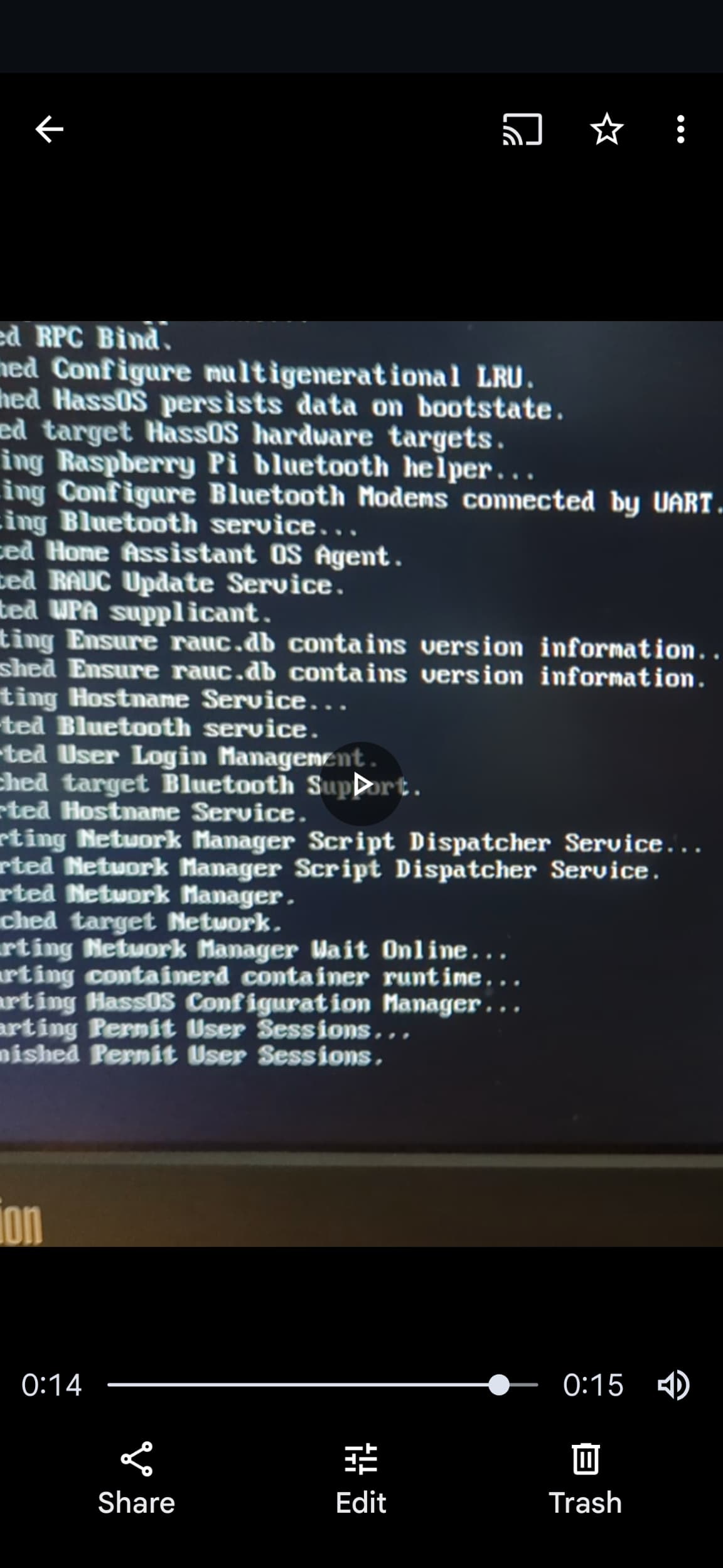

So I took video and looked at it.
It is getting to HassOs Configuration Manaer
Permit user sessions,
and then reboots

It looks like it can’t start the user sessions up.
But why it fails I do not know.

Solved
This is due to power issue. I was using some USB micro plug and cable and it looks like it is 5v 2000mA. I switched to the power cord that I ordered from Amazon along with the case and now it boots great.
