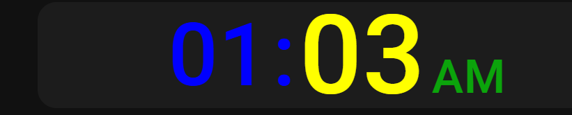

You can still isolate the elements
type: clock
card_mod:
  style:
    hui-clock-card-digital$: |
     .time-part.hour {
       font-size: 4rem;
       color: blue;
     .time-part.minute {
       font-size: 5rem;
       color:yellow;
     .time-part.am-pm {
       color: lime;
       --ha-font-size-xs: 30px;

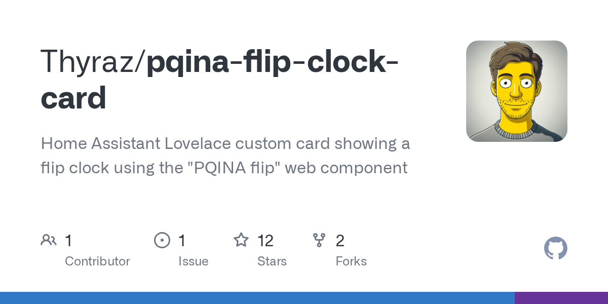

Although clock card is nice, it’s pretty much useless “as is”. For a start, even “large” is way too small, and you can’t shape it to your needs… so card mod is a must here. Although i tend to avoid css use in my cards for this very reason that they can stop working with some HA updates, there are cases where css styling is the only way.
Check out this :arrow_down:
It’s old school, but I love it!
The mods are built in…
“old scholl for old guys” (i’m going towards sixties…).
Great card, reminds me to clock we’ve used to have back then… thanks! I’ll definitively use it.
Then we are on a similar timeline. Sounds like I am only slightly behind you! :rofl:
