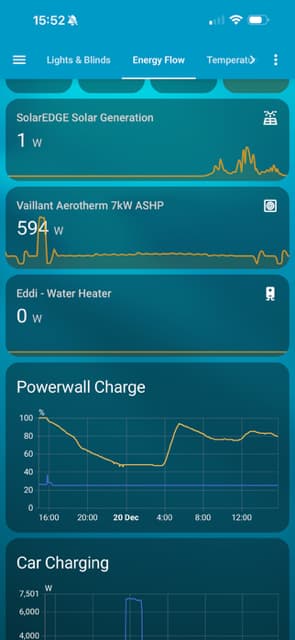

A properly setup ASHP on weather compensation has almost nothing to control. I have a Vaillant 7kW Aerotherm, and other than adjusting the heat curve when I upgraded the bedroom window and insulation, it’s not something that needs any human input. What I do have is a CT clamp on the ASHP power line connected via my myenergi Eddi to monitor it.
