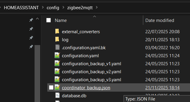

Not very helpful response from me but that looks almost exactly like the issue I’ve been dealing with this morning. In my case it turned out to be a mismatch between the old Z-Stack backup (from a TI-based coordinator) and the new stick running EmberZNet. Zigbee2MQTT won’t accept a Z-Stack backup on an Ember coordinator, so it throws that “backup not for EmberZNet” error and the adapter crashes.
Easiest way (if you have samba installed) is to rename coordinator_backup.json to something else like old_coordinator_backup.json
many thanks it works, !!
