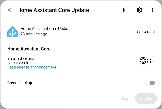

:camera_with_flash: Screenshot
The integration hooks directly into the native HA Update entities.
