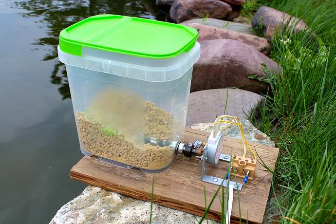

Here is a DIY one
Just swap in a ESP32 for custom remote control setup.
