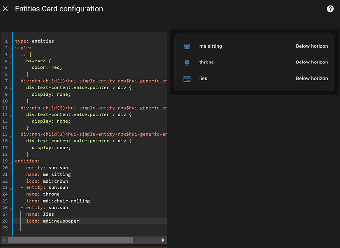

You sit on a throne of lies! :crazy_face:
type: entities
style:
    ha-card {
      color: red;
  div:nth-child(1)>hui-simple-entity-row$hui-generic-entity-row$: |
    div.text-content.value.pointer > div {
      display: none;
  div:nth-child(2)>hui-simple-entity-row$hui-generic-entity-row$: |
      display: none;
  div:nth-child(3)>hui-simple-entity-row$hui-generic-entity-row$: |
      display: none;
entities:
  - entity: sun.sun
    icon: mdi:crown
  - entity: sun.sun
    icon: mdi:chair-rolling
  - entity: sun.sun
    icon: mdi:newspaper
What version of card_mod are you using?
The result of your posted code
With card_mod added
The need for card_mod was a change in card-mod 3
Ha, I guess I sit corrected, my apologies! I didn’t realize card mod was still at work under the hood.

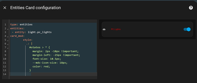

The code you provided worked other than the fact you didn’t define an entity
type: entities
entities:
 - entity: light.pc_lights
card_mod:
        style:
            #states > * {
              margin: 2px -10px !important;
              margin-left: -25px !important;
              font-size: 10.5px;
              --mdc-icon-size: 18px;
              color: red;

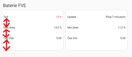

The core should be on version 2025.2.1
Sorry, I copied only part of my code and accidentally deleted the entity.
Here is the full code:
type: custom:mod-card
style:
  hui-horizontal-stack-card$: |
    .card-header {
      font-size: 18px !important;
      margin-top: -20px !important;
      margin-bottom: -15px !important;
      margin-left: -10px !important;
card:
  type: horizontal-stack
  title: Baterie FVE
  cards:
    - type: entities
      entities:
        - entity: sensor.tpj4cjm04k_statement_of_charge_2

The problem is that there is too much space between entities:
I also tried to upgrade the Core to version 2025.2.1, and card-mod to 3.4.4. but it did not help.
