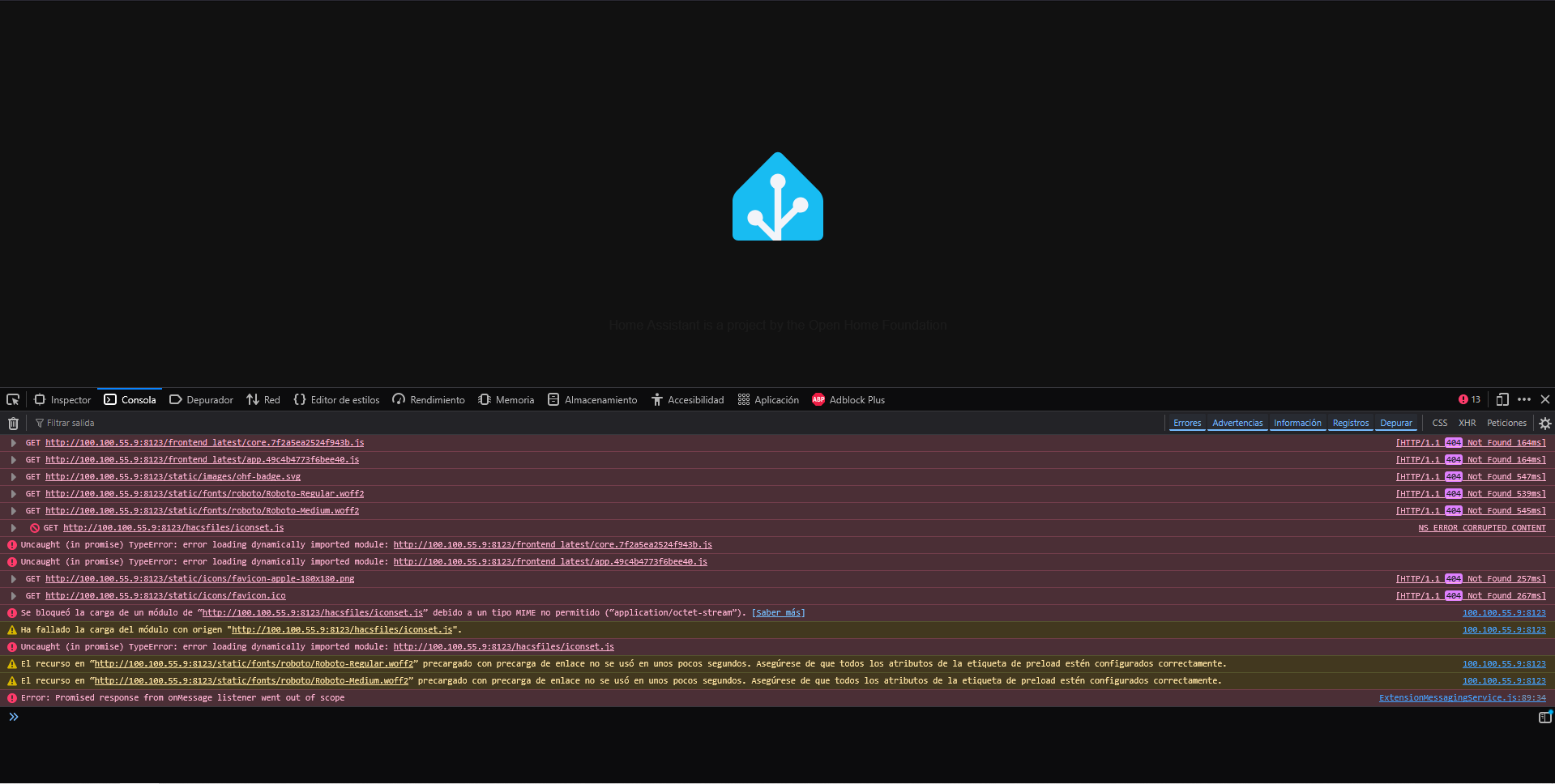

If I go to http://IP:8123 it only loads the splash screen with the HA logo. On the console there you can see that it doesn't serves the JS files. (Even after Cntrl+F5 or opening it on a private tab or another browser like Chrome or Firefox)

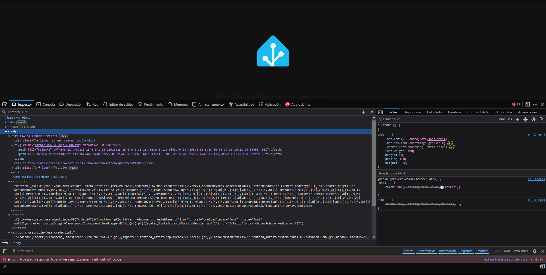

By the way, on the :8123 page it serves an HTML even after Cntrl+F5 (so it isn't a cached page on my browser) but it doesn't serves the JS as mentioned earlier.

To add some info, maybe helpful, you can see that HA is able to serve some HTML when it crashes like this:
