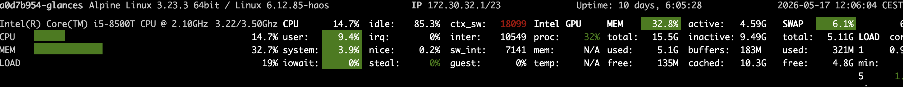

Brief update: After turning off ff the HWACC1_args in Frigate i have an uptime of 10 day's. Fingers crosed
