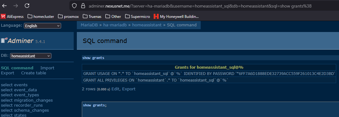

I can connect to the ‘homeassistant’ database using the set user ‘homeassistant_sql’ and respective password through ‘adminer’ OK, and that SQL account has full rights on the database.
Any idea why HA cannot connect to the db, while I can connect OK to it through adminer?

  • I did add a ‘test1’ user to the ‘homeassistant’ db with password ‘test2’ and full rights on the db. → same issue

Update: from the shell in the ha container, I can resolved the container name of mariadb and also see that the port 3306 to it is open:
28d24dcafe7a:/config# nslookup ha-mariadb
Server:         127.0.0.11
Address:        127.0.0.11#53
Non-authoritative answer:
Address: 172.16.1.3
Address: fdd0:0:0:1::3
28d24dcafe7a:/config# nc -v ha-mariadb 3306
ha-mariadb (172.16.1.3:3306) open
Z
12.1.2-MariaDB-ubu2404g6th+=2~-=I2ZRi:&K*0R+mysql_native_password^Cpunt!

I don’t think the HA log, reveal anything wrong in that end
So you might look at you user on the DB/Host, I see you have 2 places where you refer to user-passwd-file,in MariaDB container, and i assume the HOST ?
Are those identical credentials/rights ?
I was able to connect from HA shell using python and MySQLdb library with the test1 user. I used this article as a guide for that.
I’ll have another look to see if I can find out the actual credentials being used by the recorder. From initial checks it looks like they are the same in each environment though. (recorder URL, user/password files in MariaDb)
>>> database = MySQLdb.connect("ha-mariadb","test1","test2","homeassistant")
>>> print(database)
<_mysql.connection open to 'ha-mariadb' at 0x7ff4b1e4da30>
>>> cursor = database.cursor()
>>> cursor.execute("SELECT * from events LIMIT 10;")
10
>>> database.close()
>>> print(database)
<_mysql.connection closed at 0x7ff4b1e4da30>
I’ve found the root cause. It was indeed the password in the recorder url.
I overlooked a full colon at the end of the password, just before the @ sign. At that position, it’s not a seperator char like it is between username and password etc.
recorder_db_url: 'mysql://test1:test2:@ha-mariadb:3306/homeassistant?charset=utf8mb4'
versus now working url:
recorder_db_url: 'mysql://test1:test2@ha-mariadb:3306/homeassistant?charset=utf8mb4'
Thank you very much boheme61 for your help and patience. :grinning:
