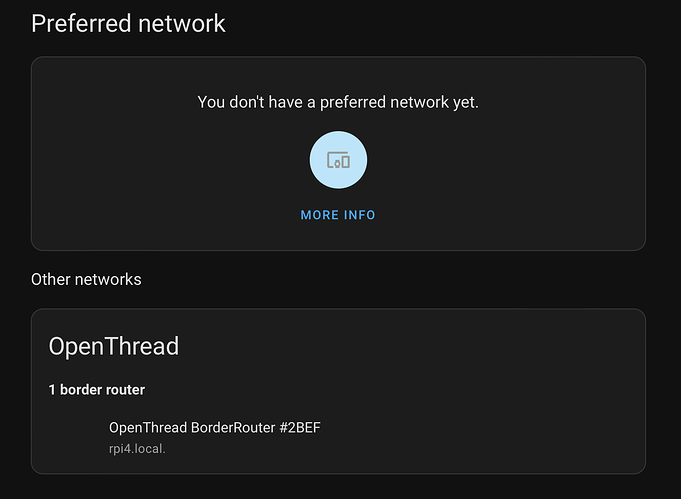

Hi guys,
I’m struggling with getting the otbr (and matter-server) up-and-running on my rpi4. I’m running an up-to-date raspbian and I’ve configured my docker-compose as described above and made adjustments to match my setup (e.g. change interface to wan0 and updated the usb serial). It seems otbr is throwing some errors that I don’t really understand:
otbr             | Feb 13 21:52:16 rpi4 mDNSResponder: Default: mDNSCoreReceiveResponse: Unexpected conflict discarding   12 F.C.8.3.6.6.E.F.F.F.D.D.A.3.A.D.0.0.0.0.B.3.A.F.E.4.4.A.2.0.A.2.ip6.arpa. PTR rpi4.local.
otbr             | Feb 13 21:52:16 rpi4 mDNSResponder: Default: mDNSCoreReceiveResponse: Received from 172.17.0.1:5353   14 1.0.17.172.in-addr.arpa. PTR rpi4-6.local.
The result is that homeassistant does detect thread as a device but, once added, I cannot configure a preferred network as shown below in the picture below.
I’m pretty sure it has to do with the errors shown above but the not sure how to fix this. I’ve attached the full OTBR log below in case that helps. Ah… and I’m using a unify cloud gateway ultra a router (in case that matters).
The docker-compose is as follows (where I wonder why the USB device is added as both ‘volume’ and ‘device’):

The OTBR logs are extremely chatty. Those look like fairly innocuous router advertisement warnings to me, but I could be wrong. Are you using native ipv6 on your network or a 4in6 tunnel? I’m not sure a 4in6 tunnel will work, but it may.
I’m also not sure why the menu doesn’t appear for some people, but you can check out the post here. I’ve never experienced the problem, I just remembered seeing posts of something similar.
I don’t believe @aleer’s image has an arm version yet, but you could build the image yourself using a different base image to try it out if all else fails.
I’m running an IPv4 network for the moment (but can easily switch to IPv6 I suppose by changing the router settings). No idea what you mean with a 4in6 tunnel to be honest.
I did do several restarts of the host, one or more of the containers or even a rebuild of the docker in ‘random’ order (e.g. restart home assistant whilst OTBR is still running and vice versa). All resulted in the same; network visible but cannot be added as preferred.
Based on what I read, I thought the image was suitable for rpi though. I might be wrong but I don’t think I have any issues with running the container.
Thread networking requires local ipv6. I would enable ipv6 in your router and see if that makes any difference.
The stock OTBR image is available for arm, but it doesn’t have the extra home assistant tweaks found in aleer’s image.
You can’t make a thread network preferred unless HA knows the credentials, signified, for some reason, buy a circled (i) beside the network name — I don’t see that in your screenshot suggesting you haven’t imported the credentials yet. The list on this screen shows networks HA has detected, not networks it has control over.
For OTBR instances, this should happen when you enroll your border router with the openthread integration. You can do this by selecting “Add openthread border router ” from the hamburger menu in the upper right corner of the screenshot you posted and entering the REST URL for your new OTBR instance. It might even be auto-discovered under devices and services.
I just checked my router settings, ipv6 was already enabled.
Maybe too much details for this topic but what is the main reason to switch from the default otbr image to aleer’s version?
I got it to work. It turned out that indeed I need to run the OTBR integration first, then thread and lastly matter. Now I have a preferred network and I’m able to add matter devices.
