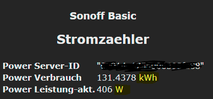

I have an electricity meter that delivers the current electricity consumption and the total number of kWh via MQTT.
grafik
In Tasmota I see the units “kWh” and “W”.
Only the value is transmitted via MQTT, but not the unit.
