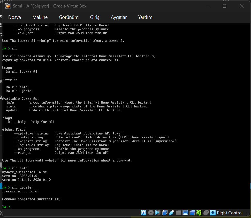

i see these
please take a screen shut and post it here, bc i don’t see what you see :wink:

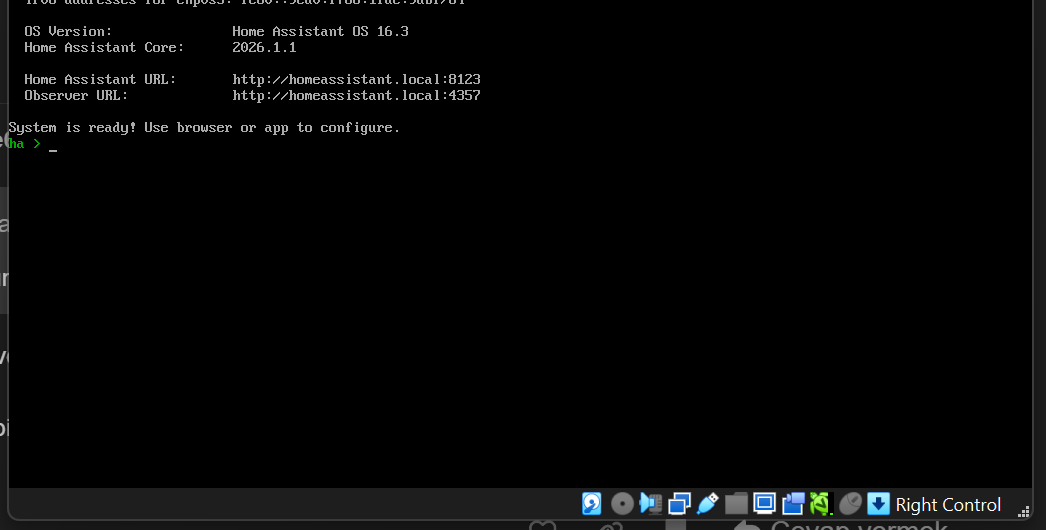

I hope I have shared the correct image. To be honest, I don’t know exactly what “cli” means.
Nope, Yes you are infront of your CLI( Command-Line-Interface
please type
exit … to get a “clean” view, those commands you typed i dont need to see :slight_smile:

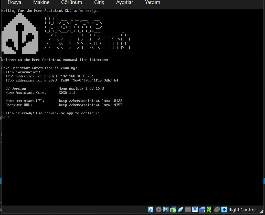

Am I in the right place now :grimacing:? There was some information about the IP address at the top; I thought I shouldn’t share it.
well that was actually the important part :wink: … and it’s safe to share those as the are " local ip numbers" we all have them and they are all same
Oh i didn’t know that, so;
Ok, it looks like it has started ok and is working, however it’s not latest core

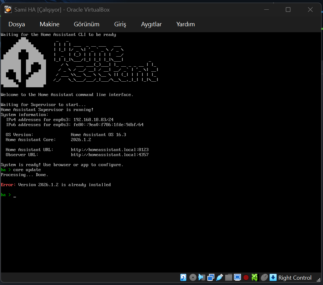

to make sure i want you to type
core update
And follow your monitor, until you see the same screen again
When all the text scrolls by , see if there is any red-colored lines
PS: was there other Updates in you GUI when you clicked first time update before ? like “Supervisor” ? …
I restarted after a successful “core update”. It appears to have updated from 2026.1.1 to 2026.1.2. And yes, if I remember correctly, there were updates available for ESPHome and a Zigbee device.
