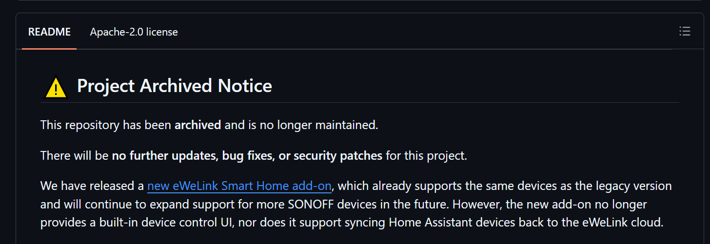

See the note in this url, this is the old way of doing things.
https://developers.home-assistant.io/docs/apps/configuration#build-args
So would be to use explicit FROM ghcr.io/home-assistant/base:latest in your Dockerfile to achieve the same build result as before.
That repository has a huge warning that it’s been archived & has been replaced by a different one
