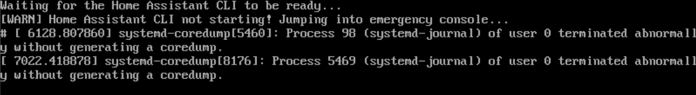

every now and then I would restart Home Assistant and it will fail to restart
I go back to my Synology and restore a snapshot that is file consistent
I start again and then it will be stuck
Sometimes I can login there and get the CLI.
Then supervisor will not start
sometimes it works after a few hours sometimes it does not.
I get various errors, the latest one is
sometimes I log into the CLI and then I try to use the commands
supervisor repair
supervisor reload
supervisor restart
they take a long time and then generally fail
