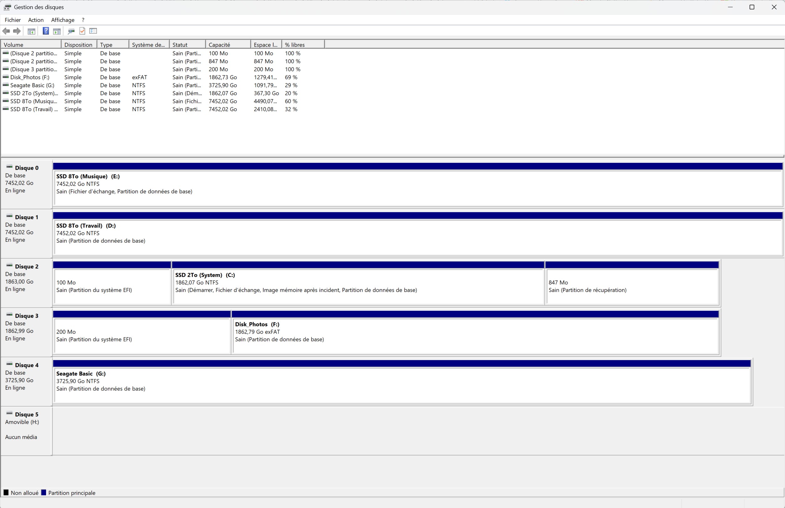

The key appears (drive H:), but no partitions are showing up. So I can’t format it.
Share what you see in Disk Management. If you want it simple you can use the SD Card Formatter tool. Yes, even if it’s a USB Stick.

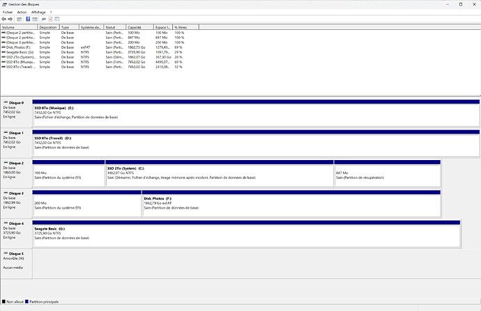

I have already tried that, but I cannot format or create a partition (error: no usable free space found).
I tried SD card formatter, but it doesn’t even recognise my stick (H:)
That looks strange/dead. It doesn’t even list a size. What USB Stick is this?
Looks like the partition table may be corrupted Use the clean command in diskpart to clean the partition table (Be VERY VERY careful it can blow away your HDD if you select disk incorrectly) for that usb. Then REBOOT then try to create a partition and format it.
