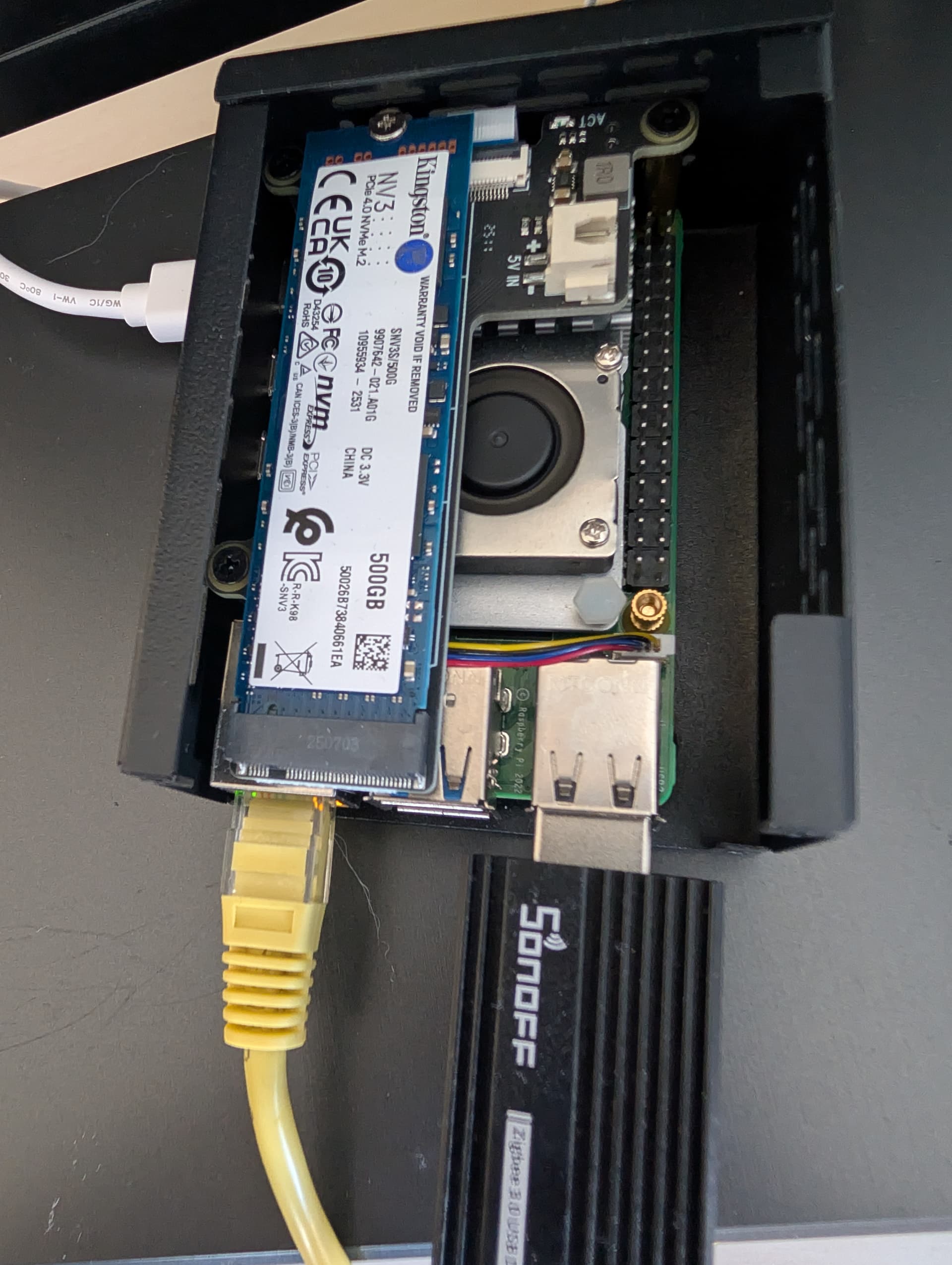

The SSD is connected directly to the RPi using the Geekworm adaptor I mentioned. The SSD is this Kingston NV3
This is my setup:
Unfortunately Kingston do not publish any meaningful specifications regarding power consumption so it is impossible to say if this is your issue. You could try powering it externally and see if it helps.
My gut says power issues. Its been a while since I played with RPi’s and never touched a pi5. But I did come across many issues trying to power ssd’s and dongles on a pi4.
Guys, thanks for the replies. I will try with a powered USB hub to power the SSD (and possibly the Zigbee Dongle), and then I’ll reply to this post again in a few days with a follow up.
