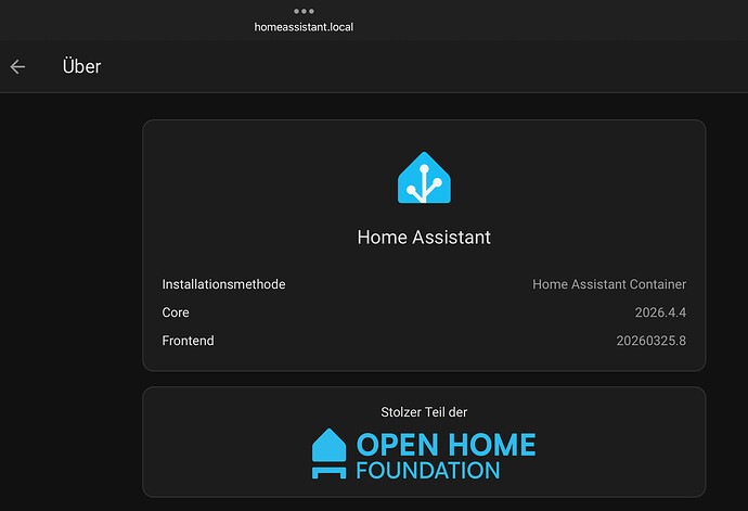

HA green arrived with container instead HAOS
New here, ordered a Nabu Casa HA green, but there is a container preinstalled instead HAOS.
Container does not allow HACS / add ons.
Why was the HA green delivered with container instead HAOS?

This can happen if the ethernet connection was made after powering the Green on. If you use the button to initiate a shutdown, then wait for the lights to be inactive and press the button again to power it back on, it should show as an HA OS install.
Thank you, I had the same problem and the above resolved the issue
