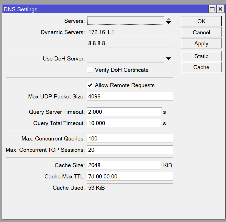

  3. For DNS, I have the attached screenshot of the settings

Your router might have the correct time but the Green does not. This can prevent SSL certificates from being validated.
Though NTP is not a secure protocol and the green should be able to reach an Internet NTP service to set the time. :man_shrugging:
If you have access to the CLI you can set the time manually.
