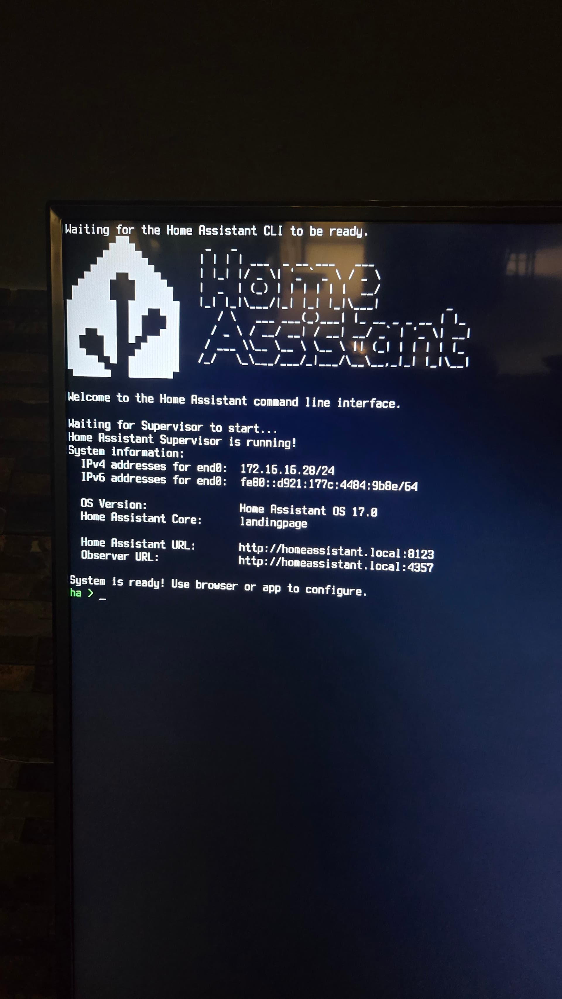

I connected a monitor/keyboard. The last line says “System is ready! Use browser or app to configure.”
Looking at ‘ha network info’ I see the same IP info and the status is connected.
