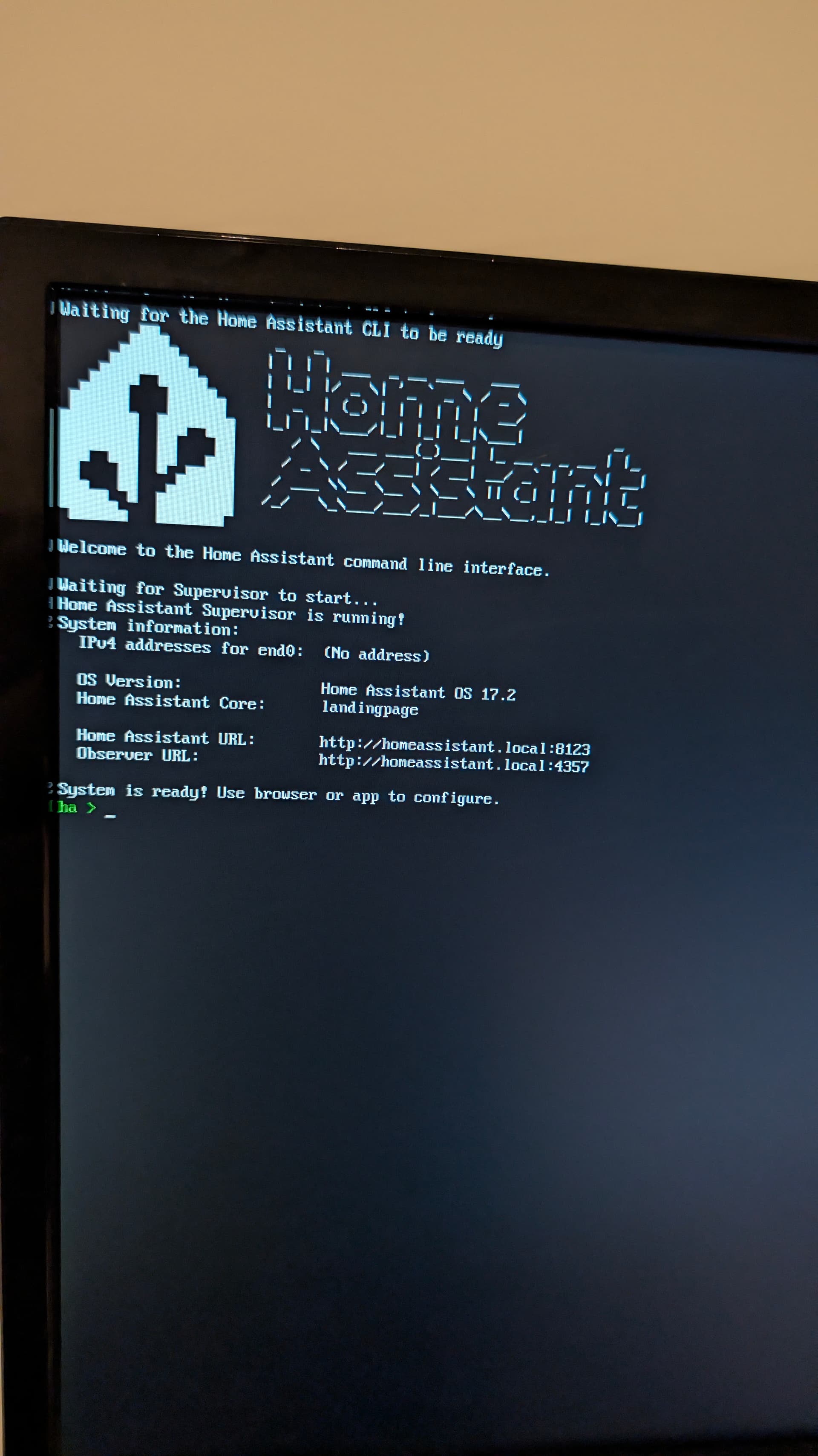

I bought a HA Green and it says it’s connected to the network. When I checked the router, Home Assistant says it’s not connected. I’m not sure how to debug. Please guide me.
Is a ethernet cable plugged in? What does ha network info say?
It says ‘no address’
That means not connected.

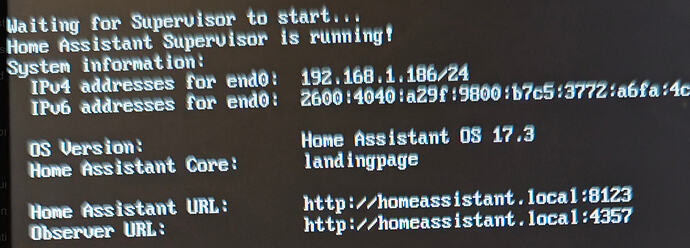

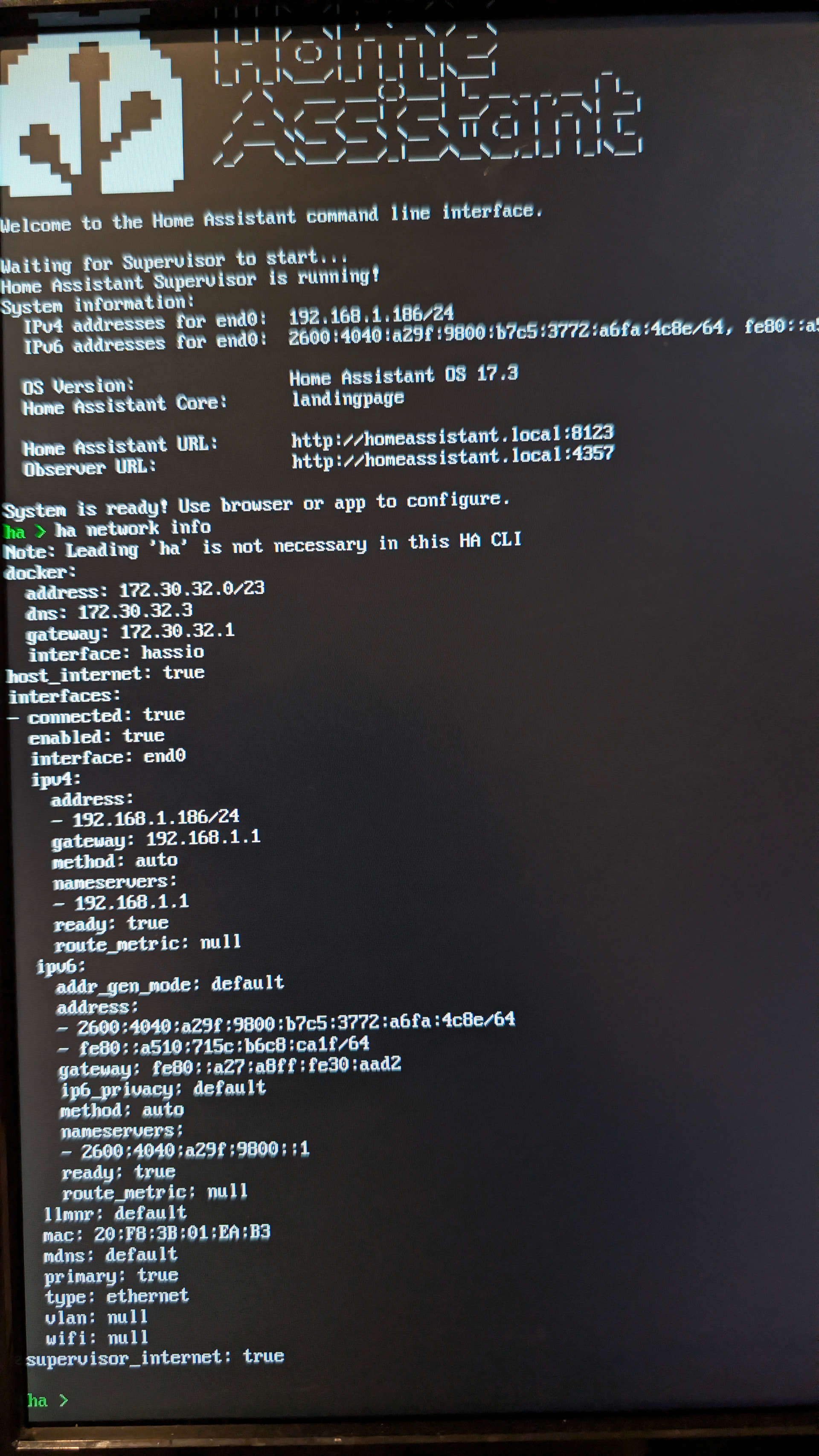

is what I see.
It's definitely connected now. Previously your Ipv4 section said no address, but now you have an IP
Go to http://192.168.1.186:8123 or http://homeassistant.local:8123 & you should get in. If you check your router again, you should also be seeing 192.168.1.186 in your list of devices.
