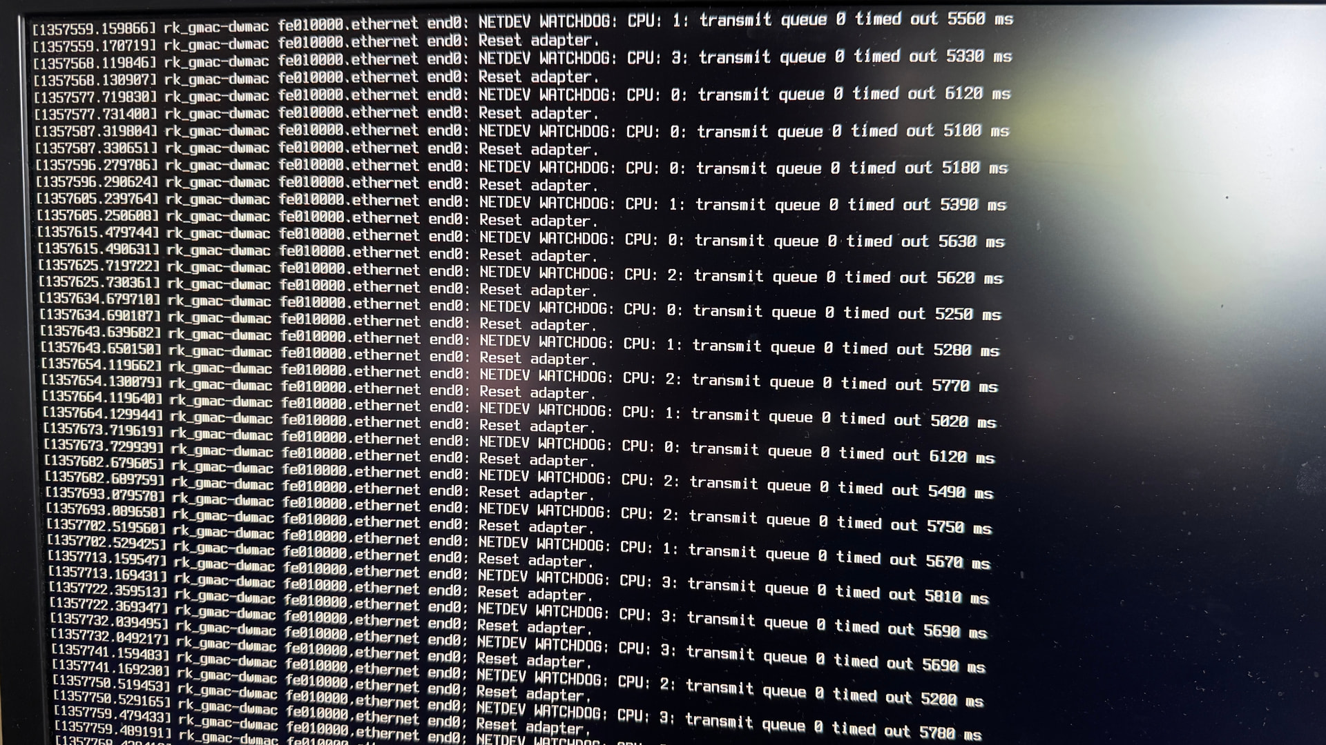

I have a Home Assistant Green that sporadically becomes completely unreachable (2-3 times per month) over night. The Fritzbox shows it under "unused connections" with the correct IP and MAC, but no ping is possible and all automations stop working.
After finally connecting a monitor while the system was in the crashed state, I found the root cause:
rk_gmac-dwmac fe010000.ethernet end0: NETDEV WATCHDOG: CPU: x: transmit queue 0 timed out xxxxx ms
rk_gmac-dwmac fe010000.ethernet end0: Reset adapter.
This repeats in an endless loop every ~9 seconds. The system is alive (LEDs normal, HA CLI prompt visible) but the Ethernet adapter is stuck and keeps resetting without recovering. The filesystem becomes read-only, making it impossible to save logs.

Same problem with another cable.
After many reboots and tries... ich saw that in network info no ipv4 address is visible (mode is auto) but status "ready=false".
I installiert a pi and tried to Connect. Not possible in Network Info no ip is displayed. Seems to be a FRITZ!Box sw Problem?

I disconntect all other LAN cable from Fritzbox (Hue Bridge, Bravia TV and PS5). Now it works ...
icb have no idea... All devices are on DHCP per default.

However, an IP address was successfully assigned later on, after I disconnected the Bravia TV, PlayStation, and Hue Bridge from the LAN.
I also noticed that the Bravia TV and PlayStation likely had their Wi-Fi connections to the FRITZ!Box enabled in addition to their LAN connections. This may have caused issues with DHCP.
