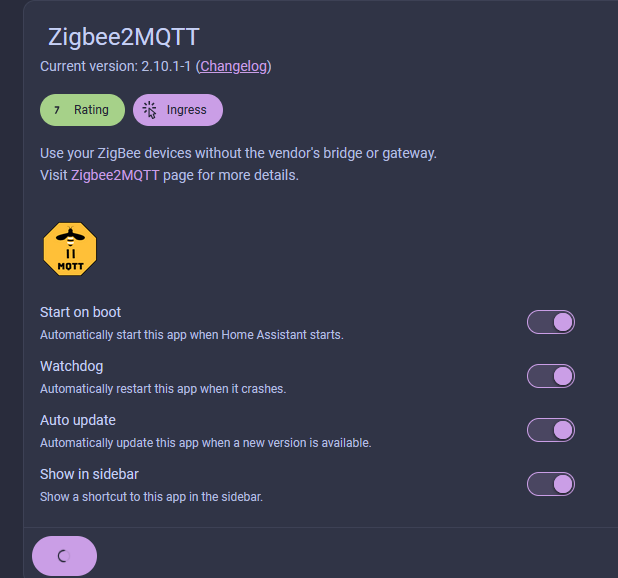

Looking at the main page of Z2M, the start just has a spinning wheel.....
De-installed Z2m, reboot, re-installed.
Did @brad.trout suggested. No joy.

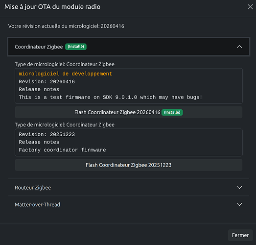

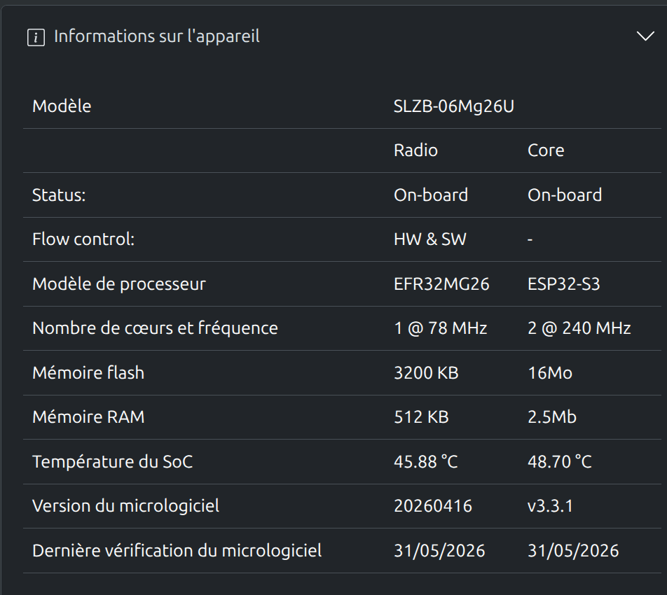

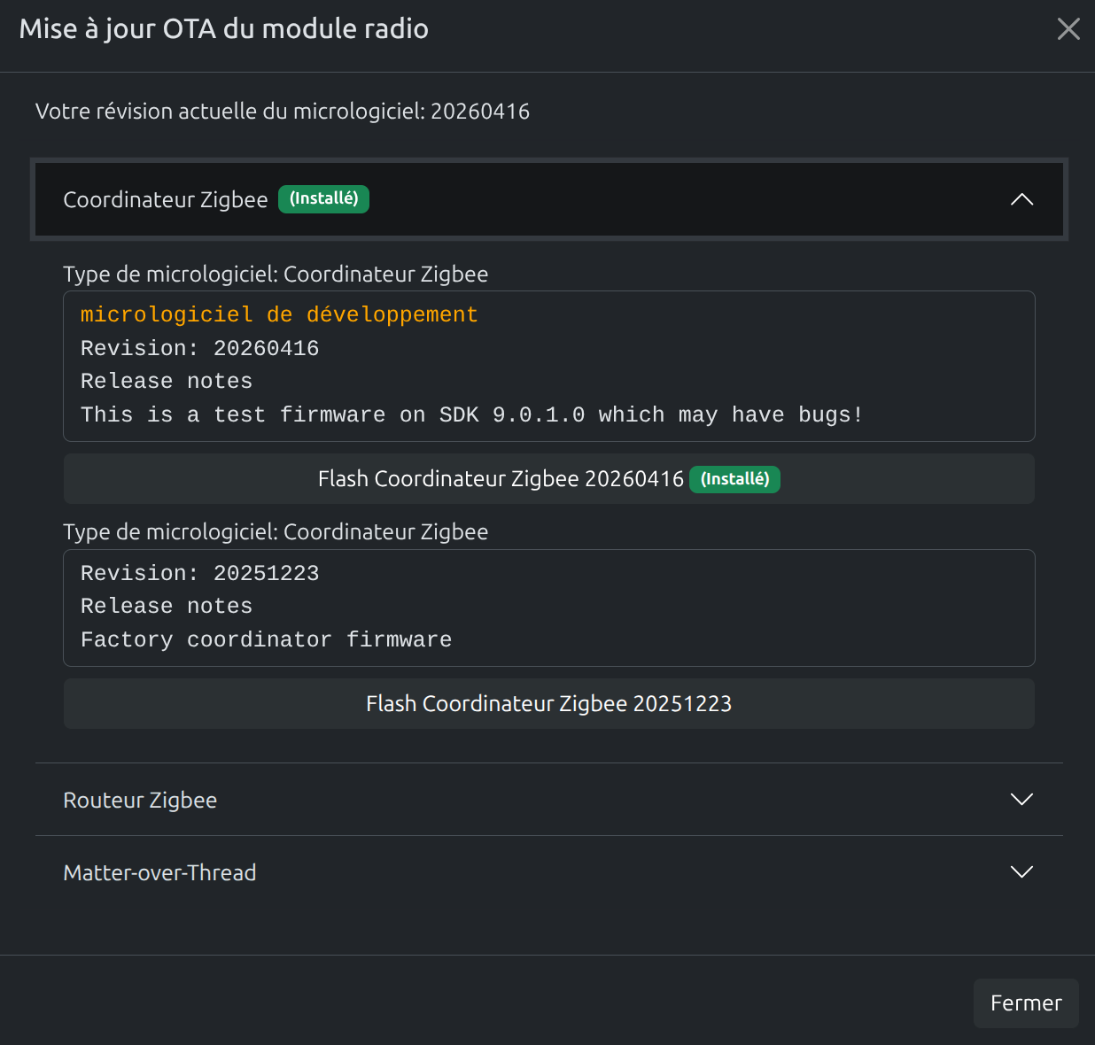

I had the same problem with ZHA. No more Zigbee since last SLZB update...
I re-flashed the zigbee coordinator's radio module with the exact same version, after I had previously downgraded the firmware to previous v3.3.1. (from coordinator's web interface)
Everything is fine again now for me (I rebooted coordinator from network and HA each time between steps).
Hope this helps!

I could not shutdown Z2M as i was not given the option apart from a spinning wheel, hence why I shutdown.

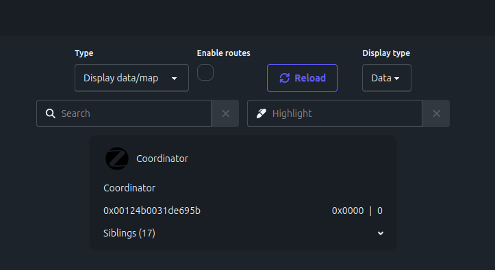

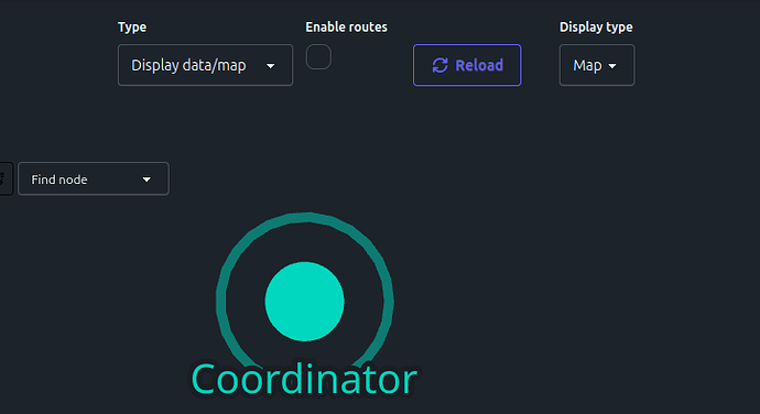

As you can see, I have no devices.
I have pressed buttons, activated PIRs and nothing is shown on Reporting section of Z2M.
This is my network page
KR, Paul
You still haven't answered my question.
The aerial is back in, I have pressed buttons on devices Zigbee switches, like aqara wireless ones
Weird. The devices should be picked up on press, since their topics are reported in the MQTT messages you posted earlier & the Map still marks 17 siblings for your coordinator.
Double check the antenna is screwed in properly & try pressing a hardwired switch instead of a button. If that still doesn't work, restart Z2M & share what it's reporting.
