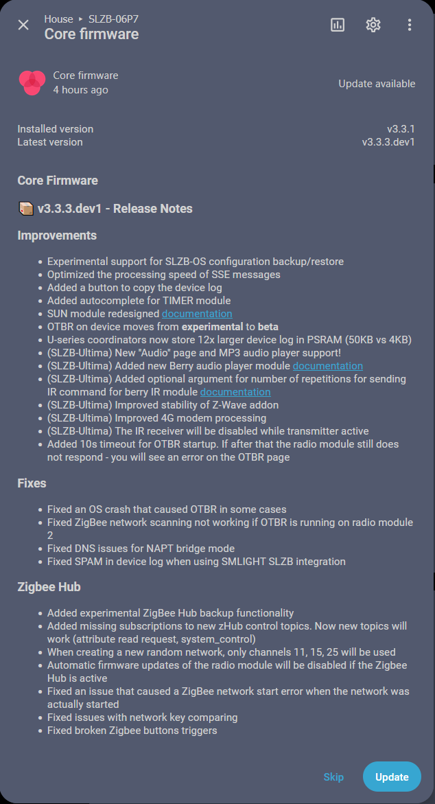

HA had an update for the SLZB-06, Zigbee2MQTT will not start

Really do not understand, as you mention, how HA have released dev firmware to the public.

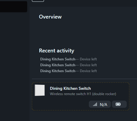

Had a spare Aqara H1 which I never fully commisioned.
When I joined it it knew its name.....

HA didn't release that version - SMLight did. If you're on 3.3.1 because you reloaded a backup, then I suggest you re-flash the firmware directly from the SMlight integration or via this SMLIGHT FIRMWARE UPDATER
I only assumed it was HA as I thought updates could only be released by them.

I suggest you contact them & ask them to add a toggle to hide beta firmwares in their OS (and default it to on). Should be pretty easy for them to implement & would avoid headaches.

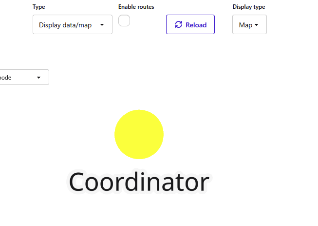

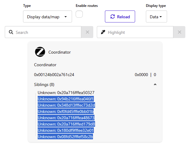

Some screen shots:
Whilst it is showing 8 siblings on the network data map, there are 17 listed in the config.
Like a bad smell, this popped up in HA tonight. I've found the toggle to stop automatic updates in the SMLight web console, under Settings and Tools -> Firmware Update and turned them off.
